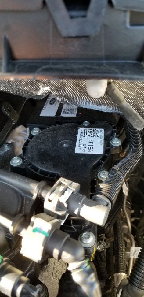

Here is my CCV, 2020 F450
That looks like a hybrid version. Part sealed and part serviceable. I'm curious to what is under the section with the torx heads.
If I were to guess it’s a single round filter element

I will have to look into it, wonder if now it could be opened without replacing the entire unit?
thats just like mine, 2020 F350. Unlike any in the videos I’ve seen. Think these have a filter?
