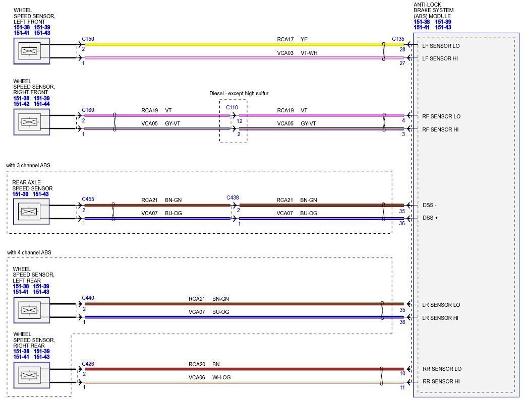

Hey guys new here don't hate to hard. I looked all over for a post of this and didn't find one so here I go. I have a 2011 ford f250 CCLB 6.2 and I was throwing a rear speed sensor code and having my spedo go crazy when it acted up then go normal when the code would stay solid. I bought the sensor and started to take it out of the rear diff and the sensor does not come out of the diff. I have spun it and moved it every which way and cannot get it out. What do I do? Do I need to pull the diff cover?

Do you have the electronic locking differential? Could the one in the photo be the ELD connector. Do you have a photo of the speed sensor? What about the wire colors of the harness shown in the photo?
I don't have electric rear diff. I have an XL model that has 0 options. I have a video I just don't know how to post it but it's the ONLY sensor plug on the rear diff so I know it's the plug it's the same shape and everything I'm just confused on why it won't come out.
