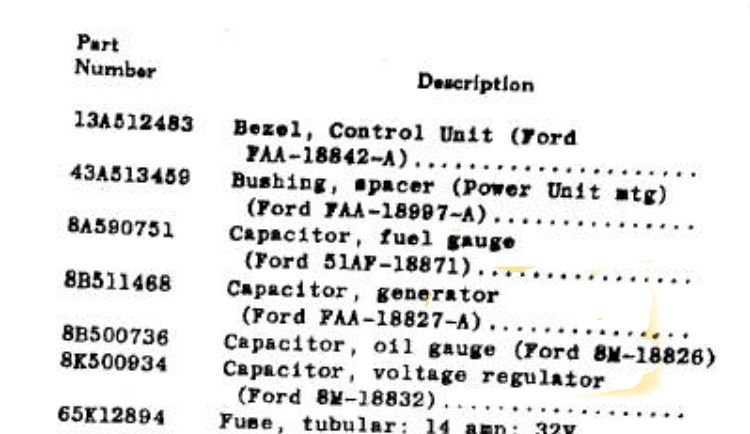

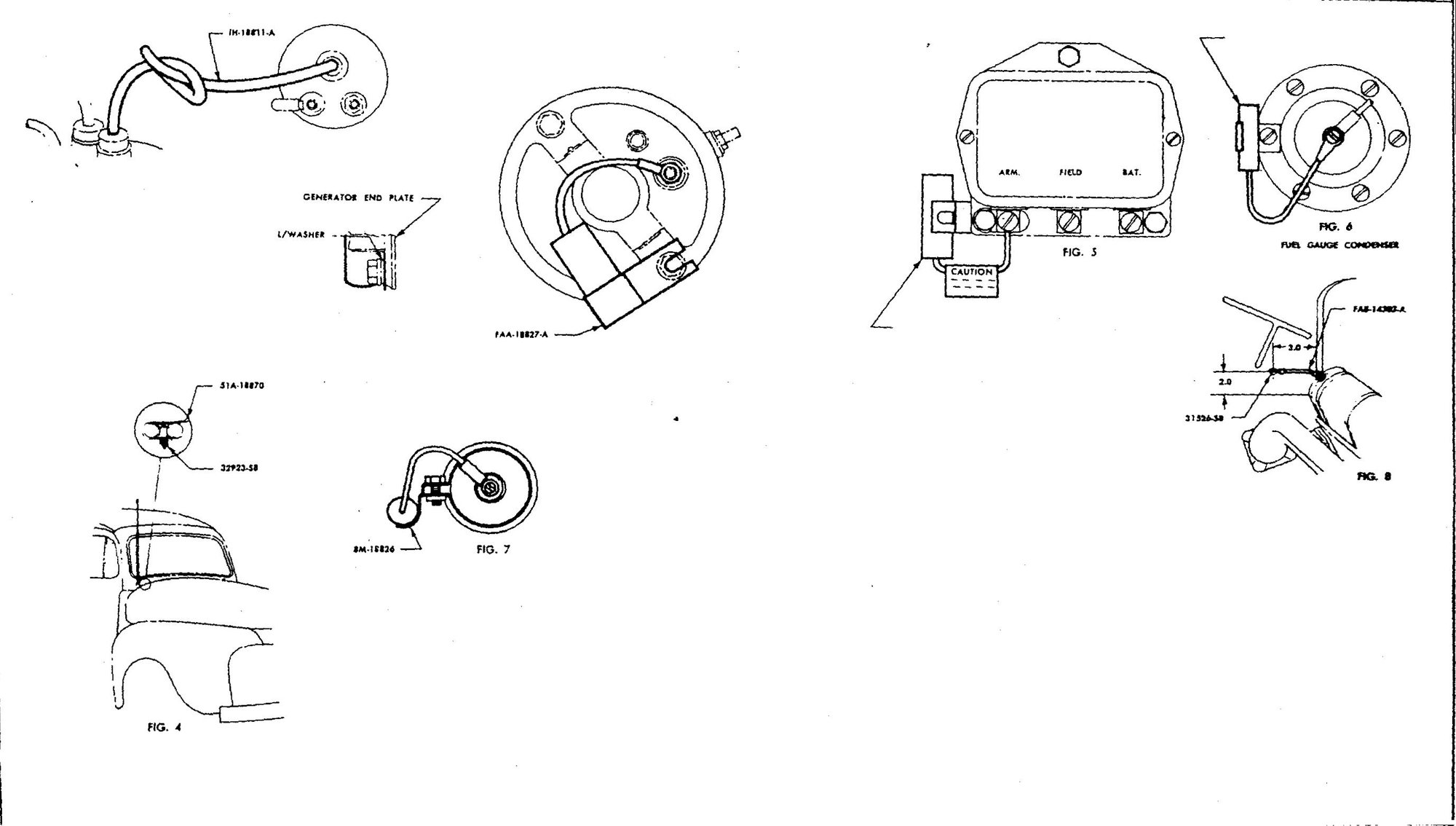

Here is the listing of the caps from the manual.

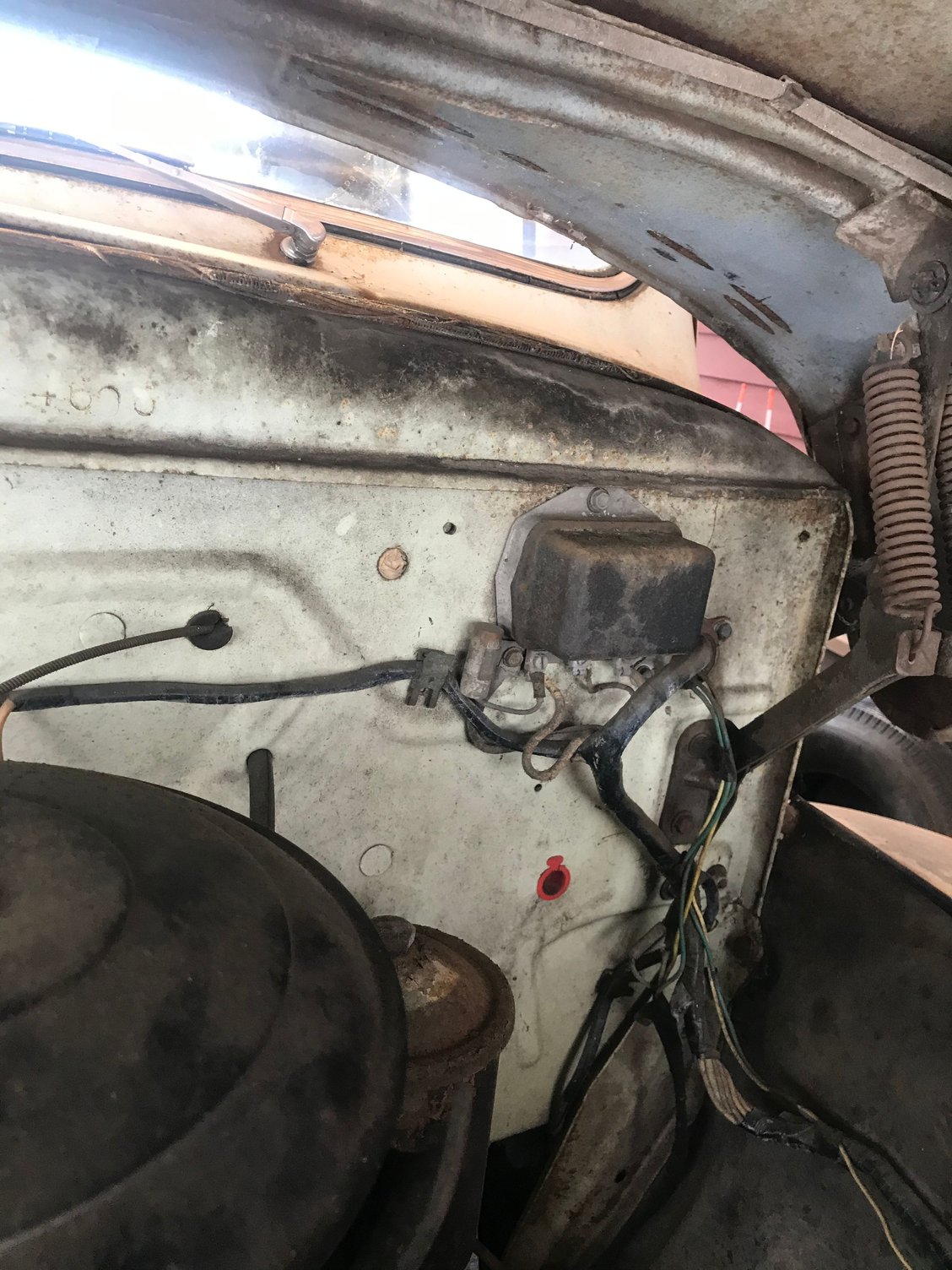

Here’s a couple of pics of original ones I took.

i think you’ll have a hard time finding exact replacements. these caps have one lead, and the ground is the case. If you’re running 6v + ground, you’ll need to find a cap with a positive ground.
I would find the value, drill them out and put a modern cap inside, then seal it up. The ground lead can be soldered to the case, hot lead to the existing wire.
