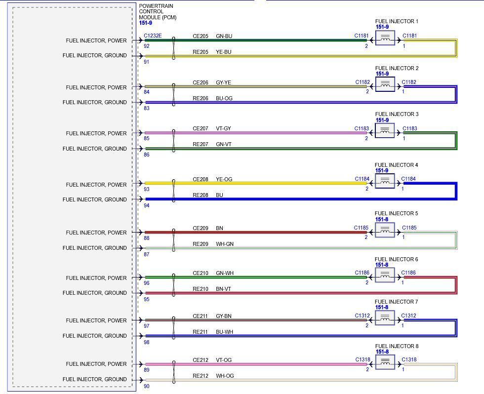

Maybe you have a frayed wire/harness on bank 1 that when cold it is grounding out to the some metal area on the engine? Once warm, items relax or move some to open the "grounding"?

Is there a hot (battery voltage) to each side. Or is there a separate hot to each injector?

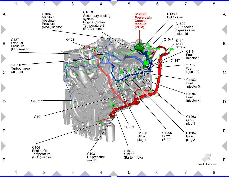

If it says HOT SIDE.....there should only be one side that is hot (12vdc)...I believe Bank 1 is the passenger side engine since it is cylinders 1, 2 , 3 and 4.

I found the problem. The wiring for injector #5 had been at one time rerouted and was pulled tight over the injector line, and slowly rubbed through. Infact it was so small of a spot I almost didn't see it. The shiny spot on the fuel line is what caught my eye. Thanks for the help!!
