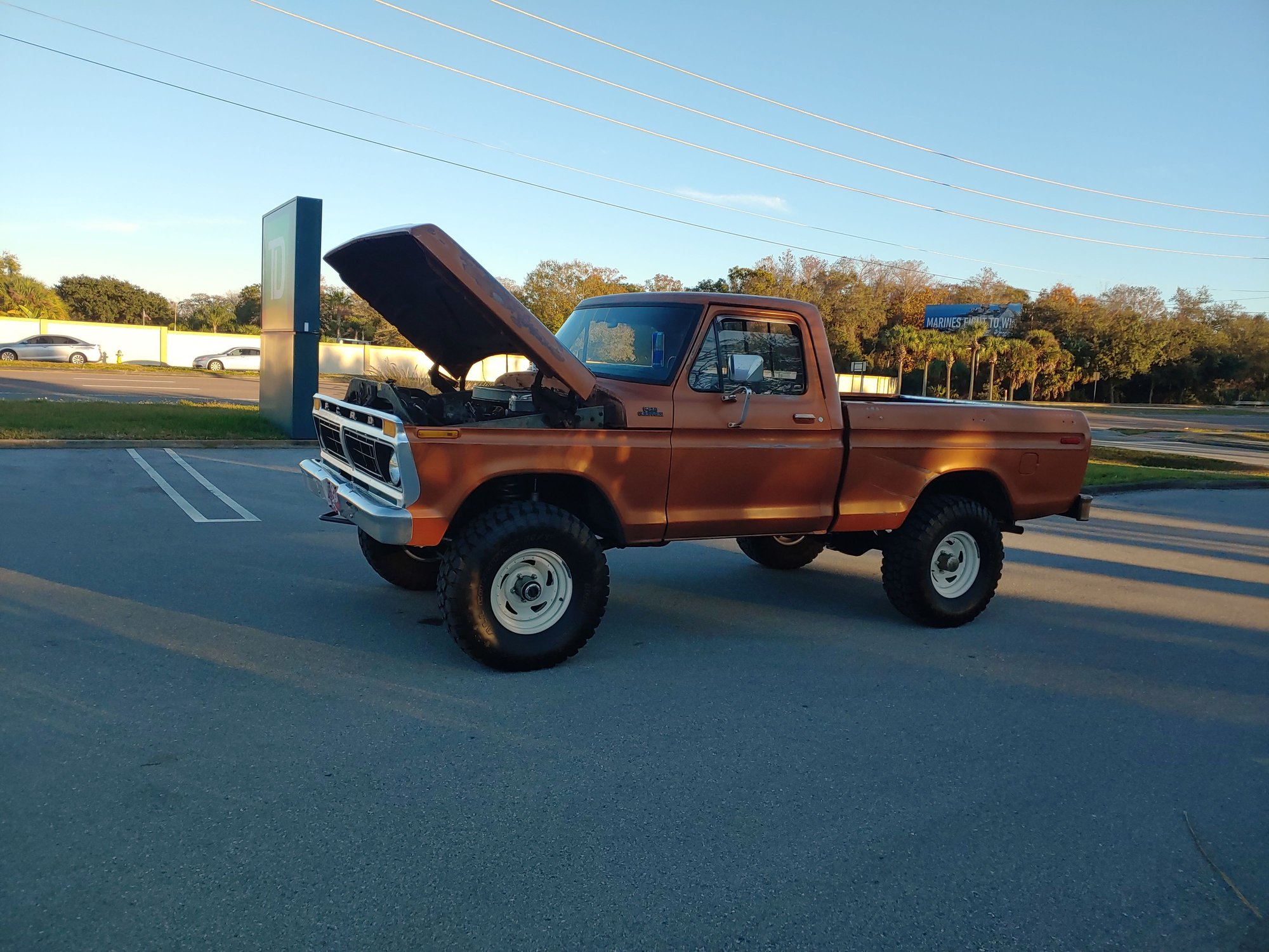

New here. Little technology challenged so this took longer than id like to admit.
came across this site while looking around on google to try and decide what to do with my tired 351
77f150 custom 4x4 short box 351 np435/205
seemed to have it all figured out.
400 crank
tmeyer pistons
for rebuild..........but I cant seem to find a 400 crank.
I see he has a rotating assembly for a stroker but thats little more than I wanted to spend. Plus machine work, cam, springs, head work etc....
My question is for you 351 guys who has rebuilt the 351? Mine seems decent now for power but.i dont know whats been done to it inside except a timing set. This I know cause while removing the pan for rear main seal replacement I found a full handful of nylon timing teeth that had been stripped off the old sprocket. Also severly plugging the oil pickup. And could see the double chain in place.
is has a holly 4 barrel carb and edelbrock streetmaster 400 intake (single plane I believe). longtube headers. Some cheap things came with truck
I drive it every day but not to amd from work. Up to store snd pull my boat (about 4500-5k boat and trailer)
She does #ok# now but I would like little more power/torque.
I have no issue out of the ramp with low first gear, or pulling boat at 70mph on flat ground just takes some time to get her there. A hill or bridge is a different story. I can still get there but shes screaming.
Main reason for rebuild is oil consumption issues.
once I fixed the rear main leaking and the valve covers and oil pan while doing rear main. It used to leal 2.5 quarts oil in 50 miles
not it does not leak oil but burns approx 1.quart on 50 miles. Has excessive crank case pressure( have pcv and it works) but will blow dipstick out of seated position if revs past 2k under load. Smokes under throttle on left bank badly, but from both. And fouls out plugs oil soaked about every 3-4 months.has good compression tho 150 approximately x each hole. So with new plugs shes nice and smooth for a few weeks.
noticed water pump leaking and that is almost the straw that broke the camel back. Then when went to start swapping water pump broke a bolt for alternator off in the head. That was the final straw. It needs it its time these are signs to just do it.
no 400 cranks to be found (yet) still looking
no decent 351 pistons to raise CR
Havent seen any 351 build threads but still looking
all the 351-400 I was reading happen to be years old.

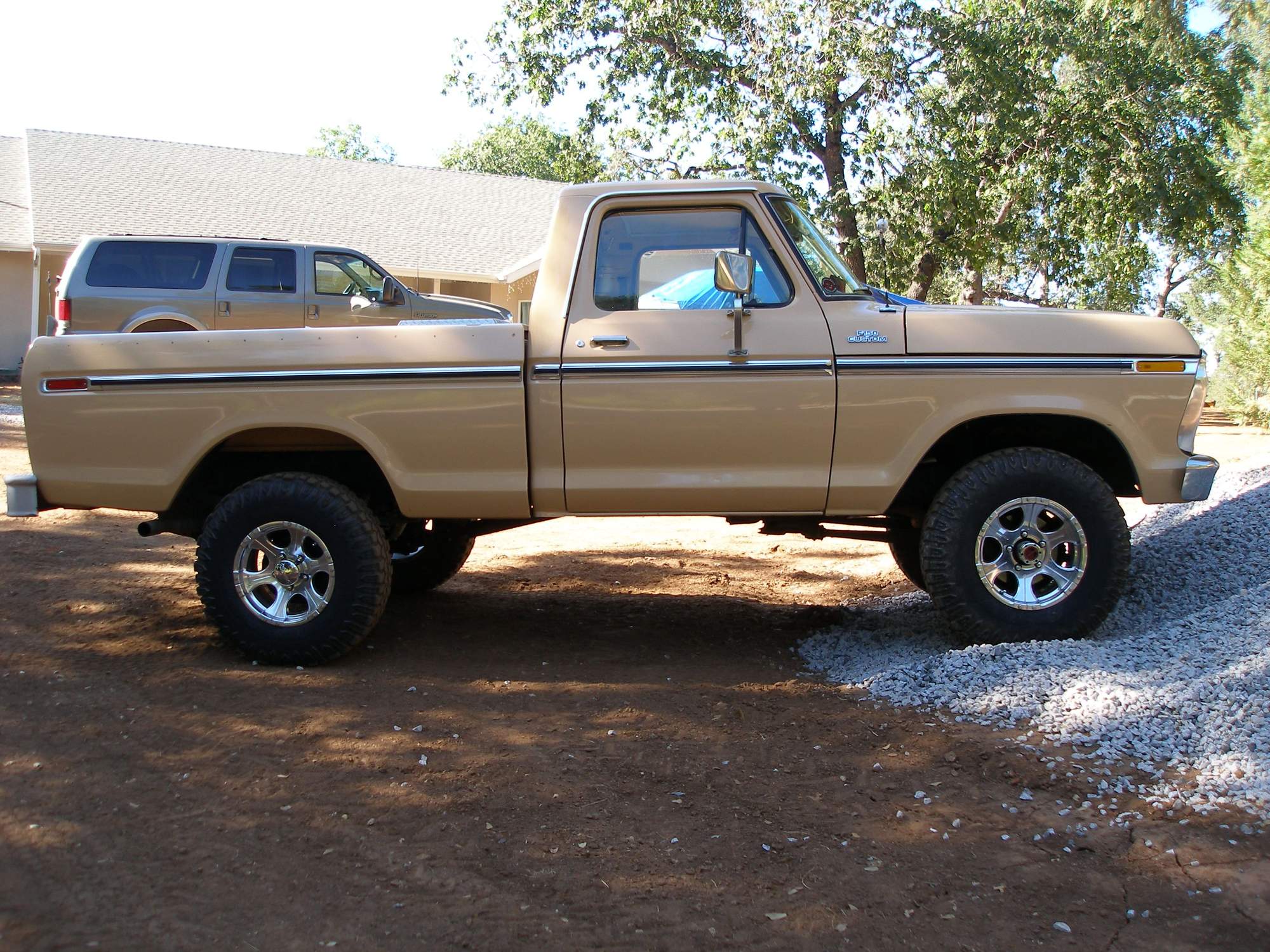

heres a picture of her

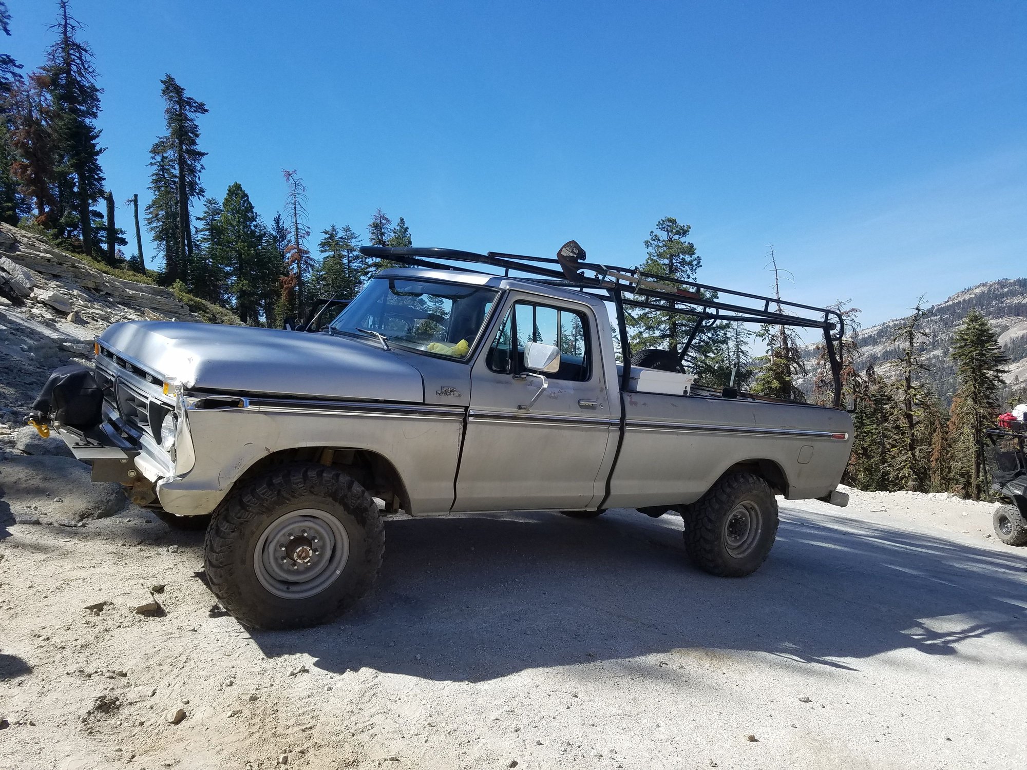

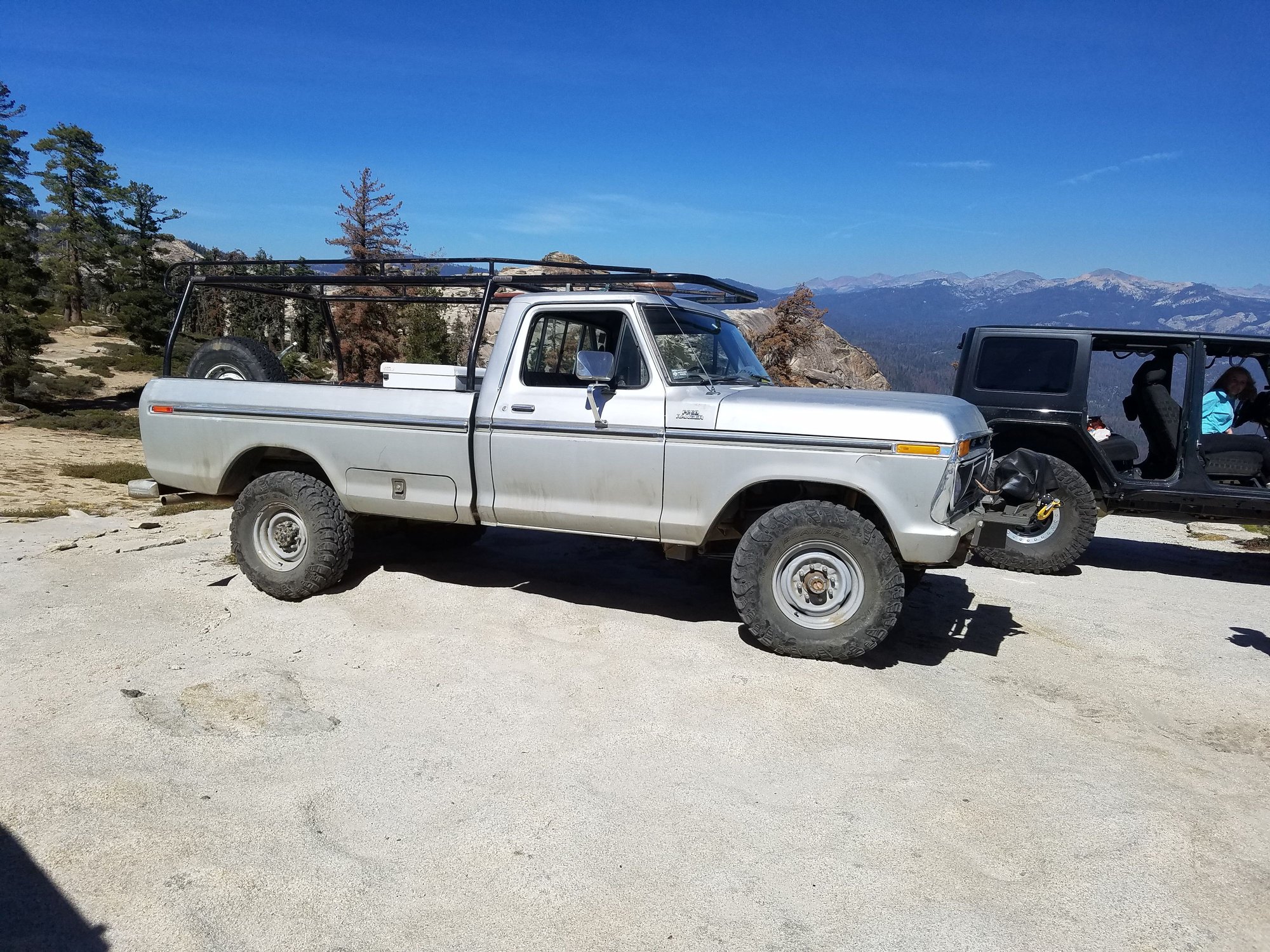

Pictures of my 77's, Sid the tan one is the pretty boy I call him, he doesn't get worked anymore, just fun driving.

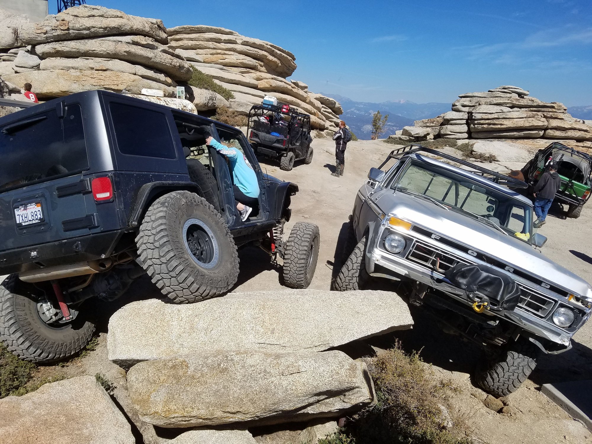

Yep, I got stuck passing gf in her jeep when she was stuck
friend w/40's didn't think my old "pile of iron" would make it with only 33's, I showed him I could!

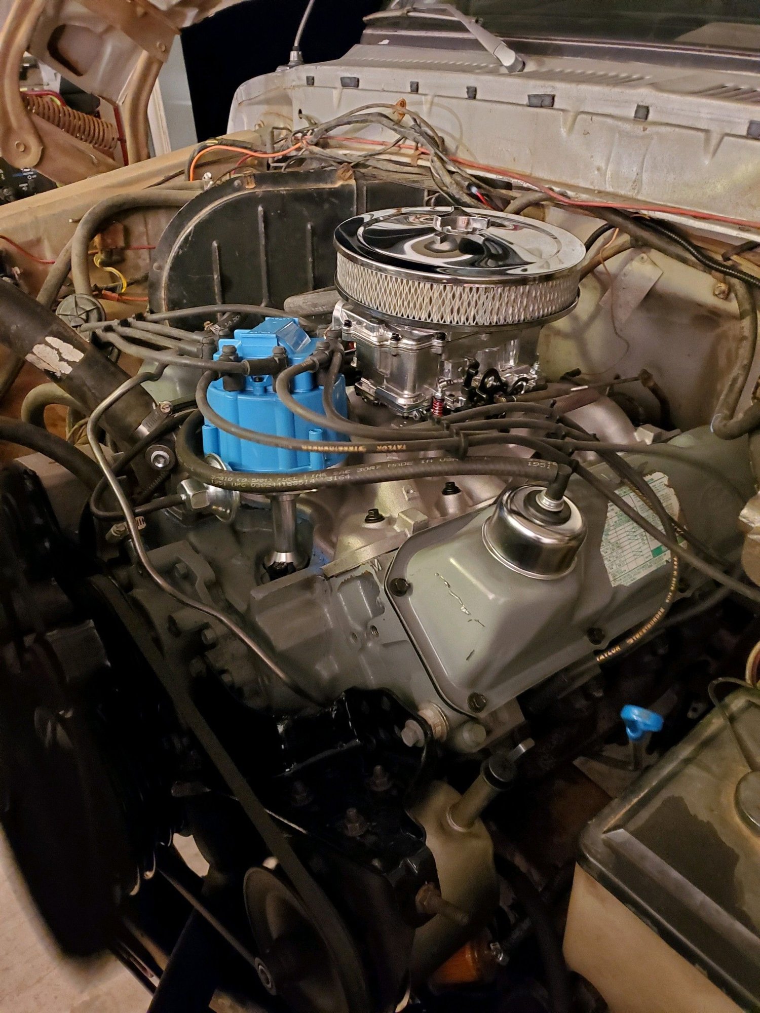

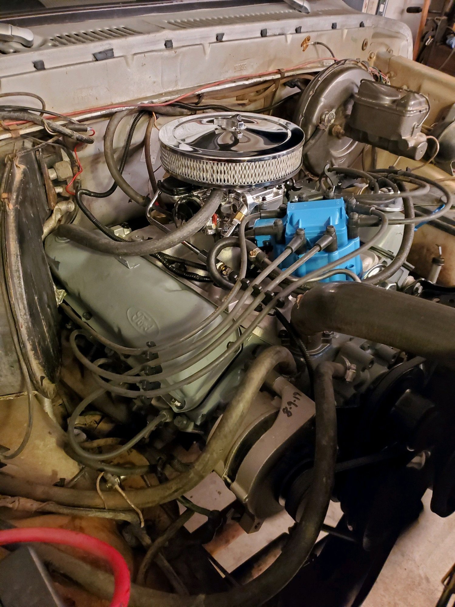

More pics, cause we all like truck ****
When I first made it
