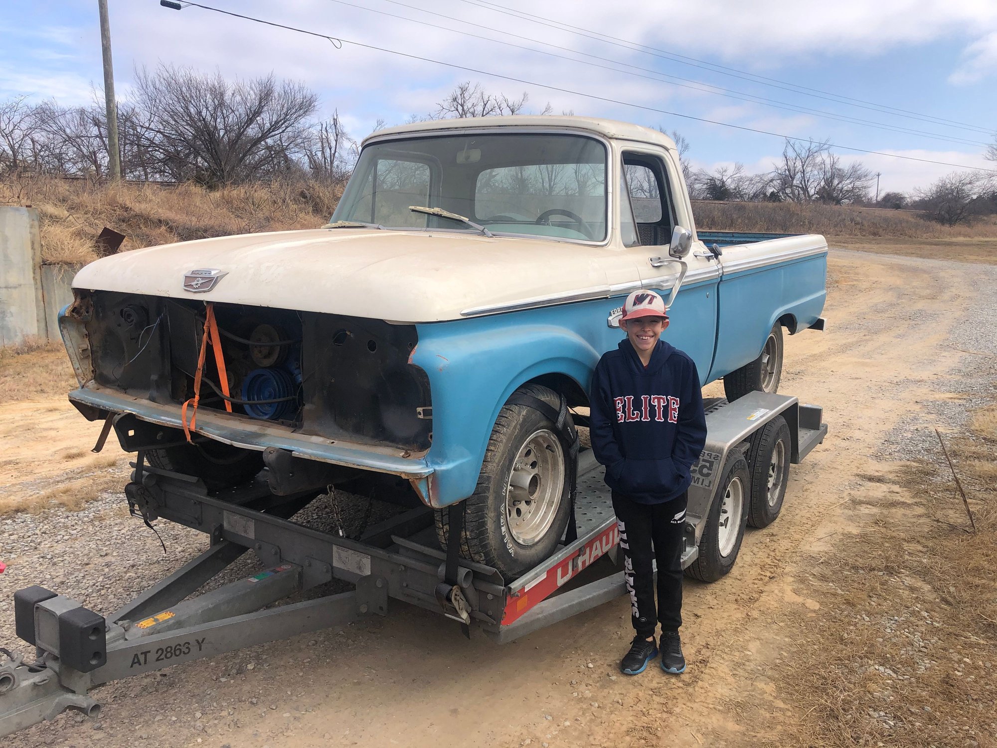

Hello all - just wanted to post up a few pics of our new project. This will eventually be my oldest son's daily driver. Seems to be pretty straight and rust free. Not running at the moment, the guy I bought it from was in the process of a motor swap from a 240 straight 6 to a crown vic 460. He ended up needing some money fast and needed the pickup gone asap - so we helped him out . I am not sure if we will keep this motor in it or what exactly we are going to do just yet. We also got the original 240 and tranny in the trade.
My son is (almost) 12, so we have a few years to complete. I will keep this thread going as we get things accomplished. It most certainly won't be a fast build...

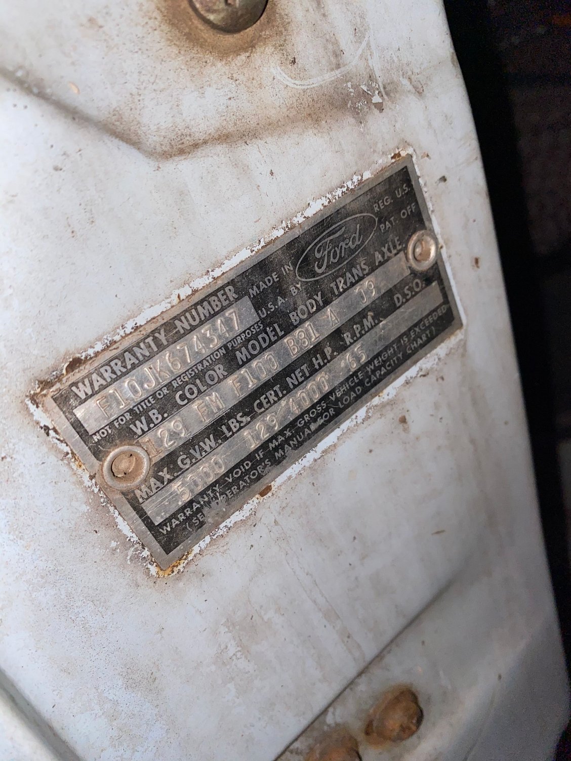

I know there are a few of you experts out there that can read these vin numbers - would anyone like to give us all the good info please?

Someone will chime in shortly to help decode your VIN, but just wanted to say congrats , and hope you and your son enjoy the project.

Woo Hoo, looks real nice, good luck you're an A-1 Dad!

Your tag decodes as follows:
F10 = F100 2WD
J = 240 I6 ('65 only)
K = Kansas City plant
674347 = Built in Apr 1965
FM = two tone Light Blue and Wimbledon White
B81 = Custom Cab with Med Blue crush vinyl and Med Blue rib vinyl
A = 3 speed light duty non synchro trans
09 = 3.70 open 9" Ford rear axle
65 = Oklahoma City District Sales office where it was ordered by the dealer, not special ordered
Nice truck, and that is a lucky young man.

Awesome, thank you for doing that! It will be a lot of work, but will be fun!

Good looking truck. I'm looking forward to following this build, good luck with it...

Lucky boy you have there. It will be a great times you will remember forever working on it with him. Build a 60s Mustang with each of our 3(Daughter and 2 sons) where they paid for 1/2 of every thing and did all the work with me.
Great color combo.
I did some things in my '65 F100 that you may be considering like 3 point seat belts. Check my posts here.
Good Luck, Have Fun.
