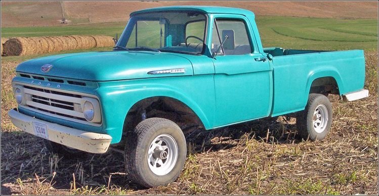

Here's a pic of a raised slick the day I got it home. Same deal - It's a father son project - my partner is behind the wheel.
This has the larger wheel wells and a straight axle, so a different animal from yours. Tires are lt315/75r16 - which google says are 34.6 inches.

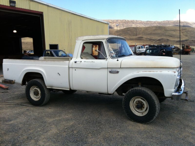

Your truck was raised from the factory. Here's one of my 1966 F250 4x4's. Same deal - somewhat smaller tires on this one. Easier to steer in tight spots. Looks like someone bobbed your bed - All F250 4x4 were 8' bed 1961-1966 if they were Styleside wrong bed. Or it's an illusion of the camera. Looks shorter for some reason.

Originally Posted by TA455HO
Your truck was raised from the factory. Here's one of my 1966 F250 4x4's. Same deal - somewhat smaller tires on this one. Easier to steer in tight spots. Looks like someone bobbed your bed - All 4x4 were 8' bed in the F250 series.
Thanks - on the bed - I was curious and asked the PO - he was unsure, since all the mod work was done by a previous PO. I have some notes, and no mention made of reducing the bed. I need to sleuth more around the sheetmetal.

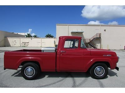

They did make a 6' "wrong bed" that was used on shortbed 1957-1960 (not wrong for those years) and 1962-63 non-unibody stylesides before Ford developed the newer styleside for 2WD in 1964.
Like this truck has. Same bed but in a 6' instead of 8'. If you have a chance turn your front wheels straight ahead and get a rough measure of the wheelbase from center of front axle to center of rear axle.

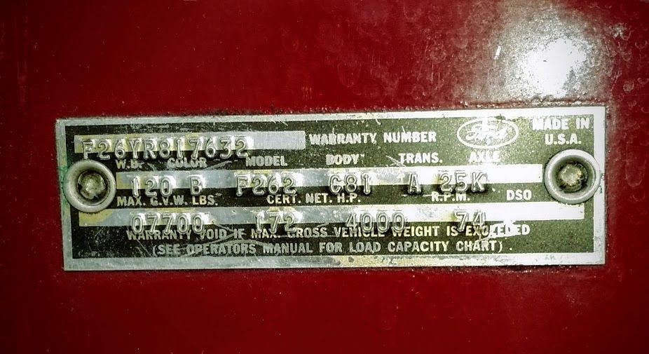

I've checked that - pretty sure it's 120". I previously looked into if there were frame chops, and pretty sure there are none. I'll spend more time on it. Here's the VIN as well

I've ridden in these trucks since they were brand new and something definitely up with the length of yours. Here's another of same year and you can see the bed seems longer than yours. The 2WD short bed was really about 6 1/2' long.
The gap between the cab and bed seems a little bigger than normal. Maybe they put a shortbed on the truck and trimmed the frame off in the back.

Read this article about the '61 to '66 truck changes, and available beds and wheelbases. This says that 120" wheelbase short bed 4x4s were positively offered in F100 and F250.
Ford's '61-'66 'Wrongbed' History - FORDification.info - The '61-'66 Ford Pickup Resource
