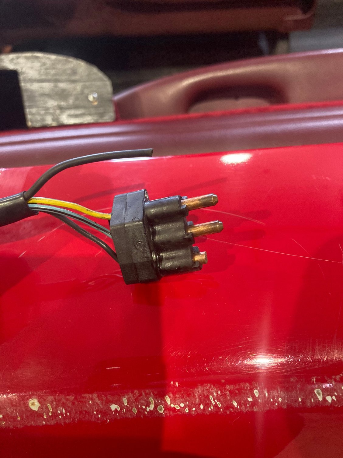

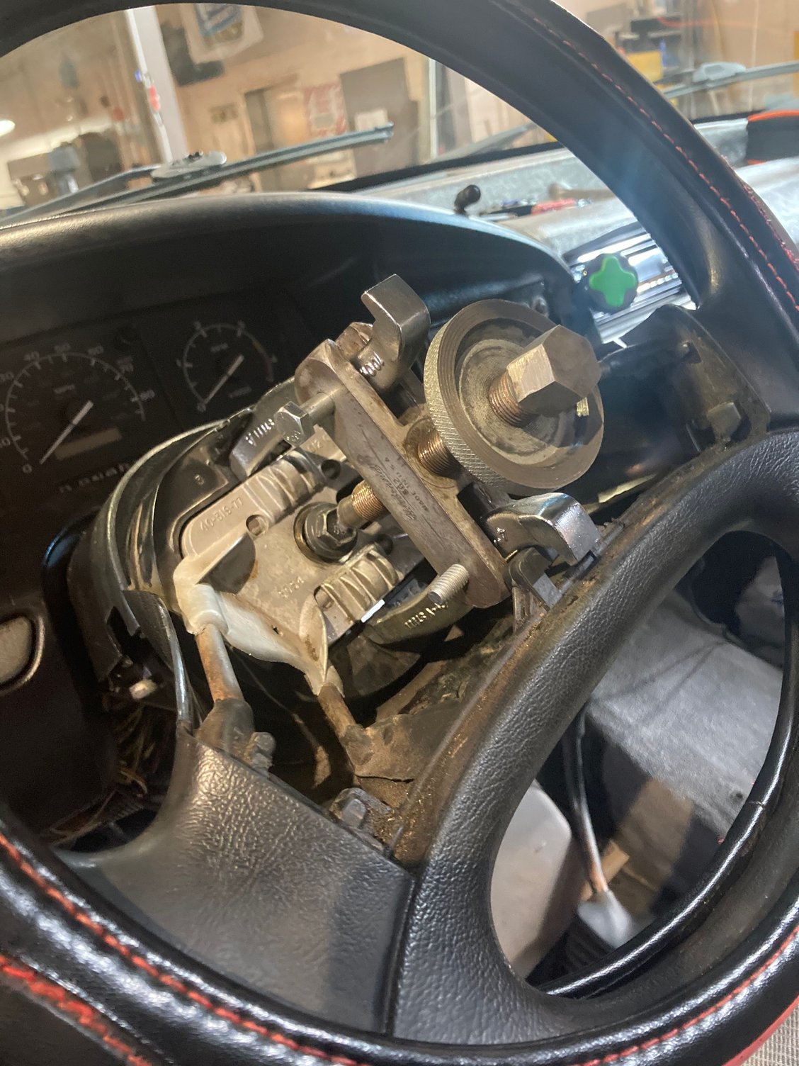

94 F350 Trying to get my steering wheel off to replace the broken 3 prong contacter for the horn/cruise. Searching showed anything from wiggling it off by hand to using a puller once volt is out. Didn’t come off by hand. I’ve removed steering wheels with a puller in the past and there was always holes to thread the puller into. This wheel doesn’t have any. I tried a regular jaw puller but I’m hesitant to put a lot (a lot more) stress on the edge of the aluminum plate. Any ideas?

Put the three jaw puller on it, add some pressure and hit the center bolt of the puller with a hammer. The vibration will help free it up.

Got it off using a “custom” puller it took a lot of force and some heat. Now that it’s off and I could get the broken three prong connector out, any other dead what the cut black wire went to?

Key in ignition dinger?
