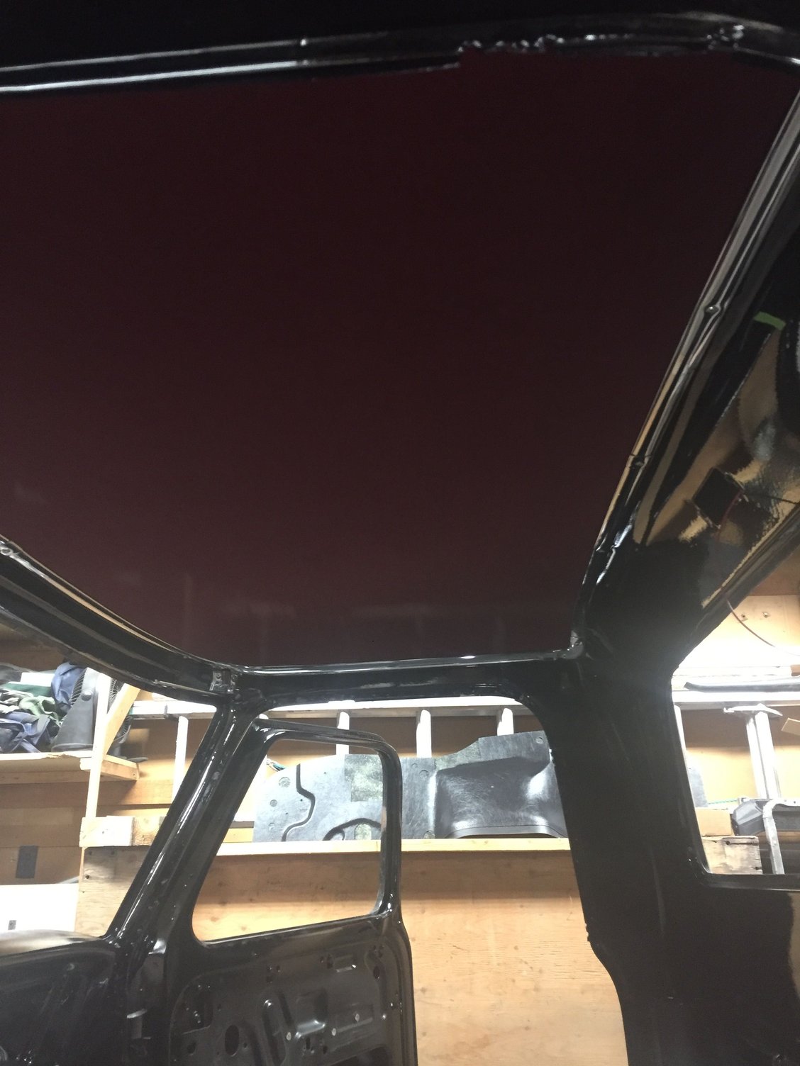

Old Jan 21, 2021 | 07:46 PM
BLKPLGE's Avatar
BLKPLGE
Joined: Dec 2020
Posts: 112
I finally got it in. It was a hell of a good time. But the DC perforated fit really well. I wish I would of dry fitted it before covering it but it still turned out. Didn’t have to cut the board at all, a win in my book.
