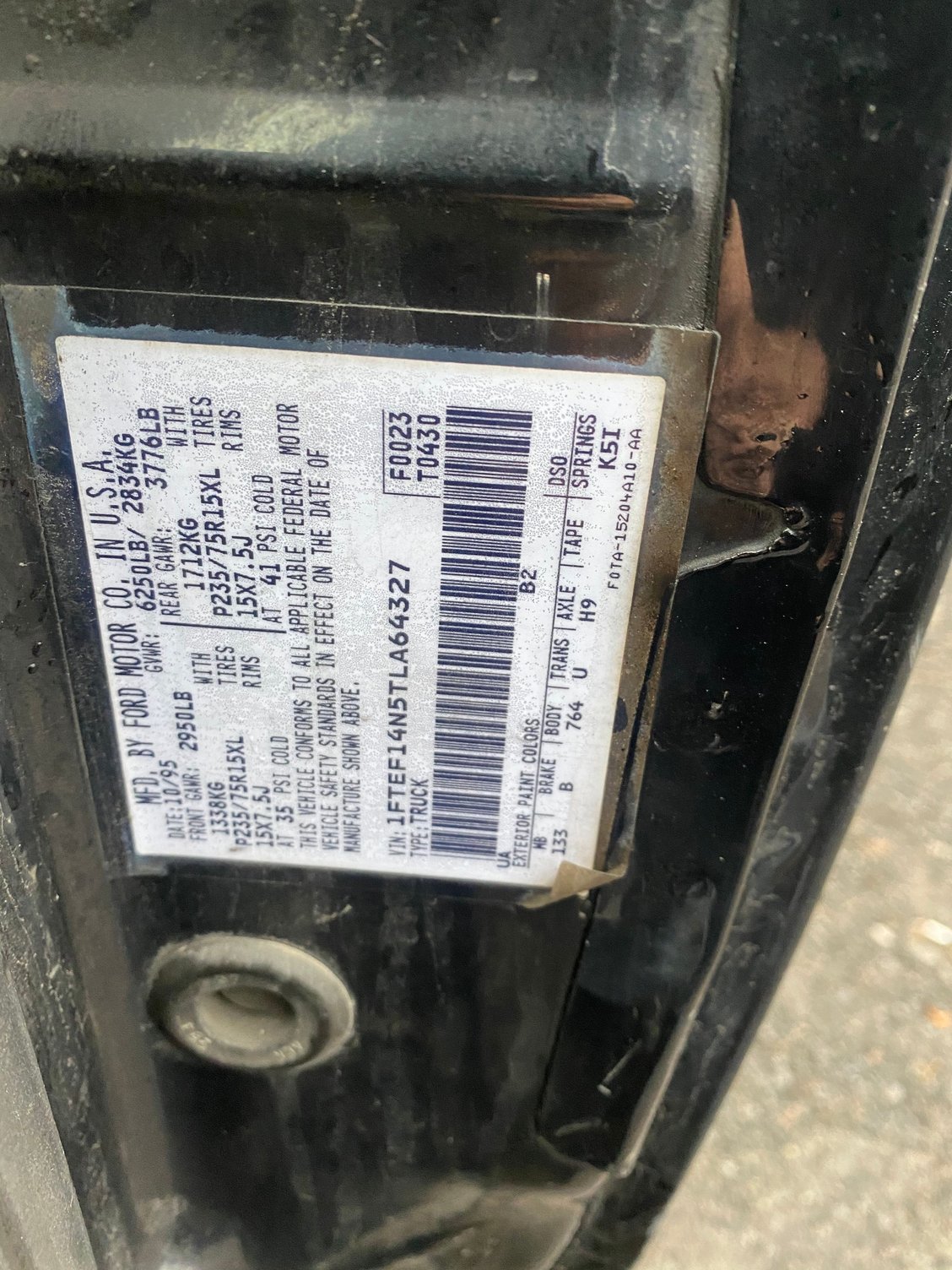

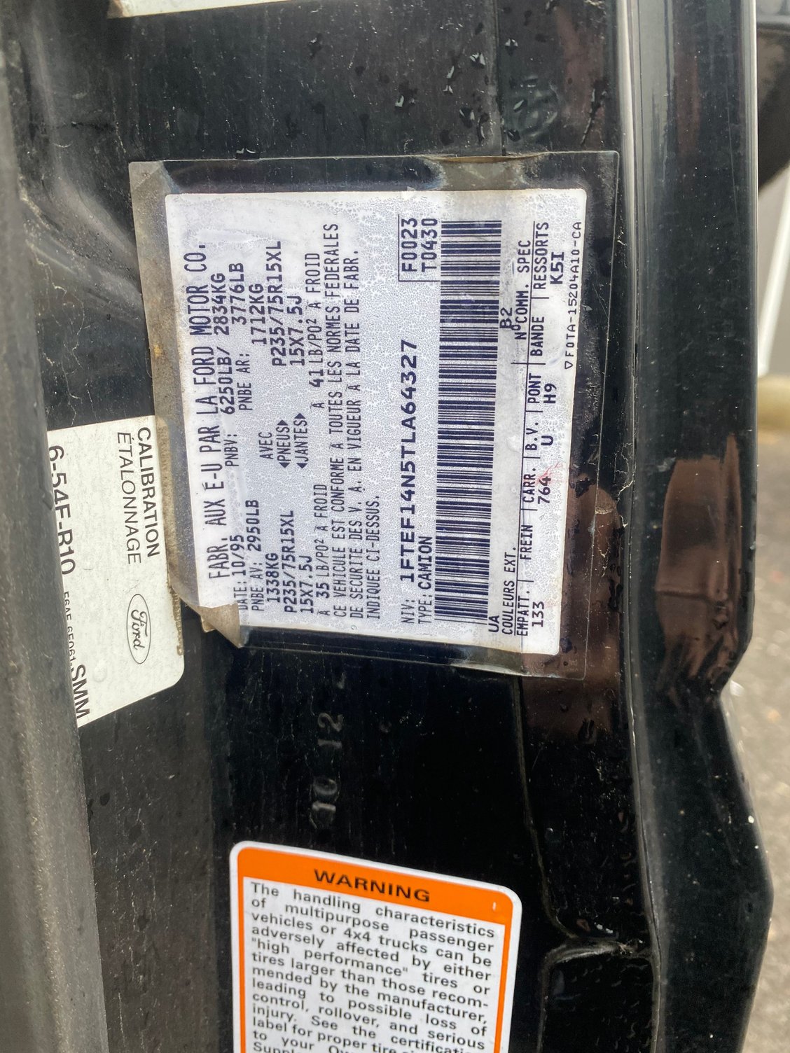

Hi how are you can you tell me what mean my vin number 1FTEF14N5TLA64327 I want know what transmission fit on my truck and I think I got the 4r70w

It's not in the VIN. The trans code is on the VIN tag on the driver's side door post but it has it's own slot at the bottom of the tag.

Transmission code U —> 4R70W
