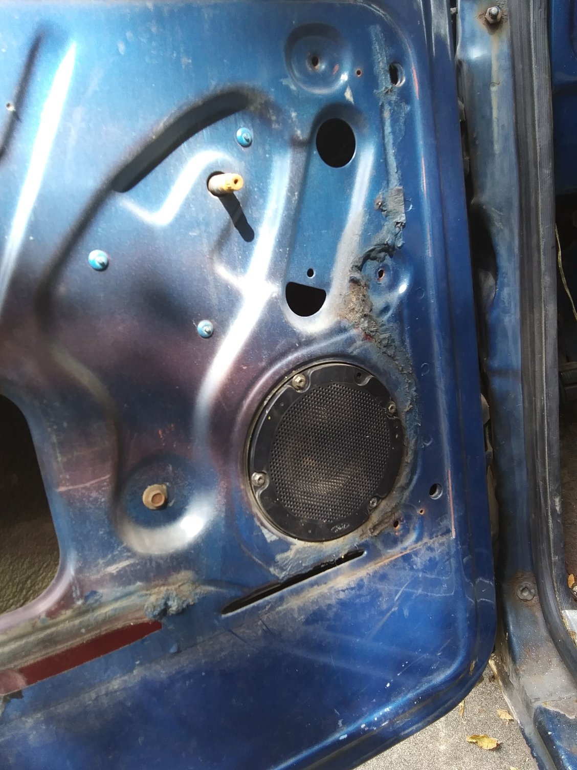

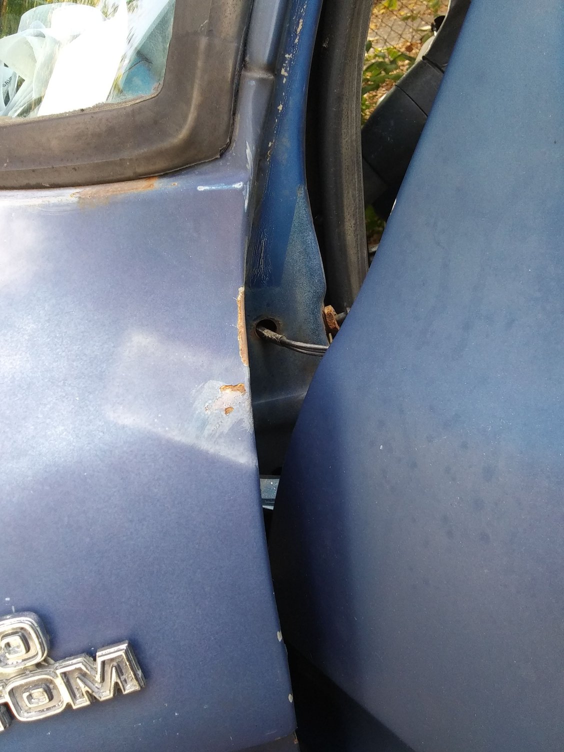

I ordered the complete Dennis-Carpenter set of wires, (I am using a modded OEM AM/FM Stereo that is converted to Bluetooth) And the DC product is great, Everything lines up, and lots of slack for any mistakes. Well worth the money, grommets and little tabs are included!
These are photos from doing the install, So not perfect, but does give you and idea!
