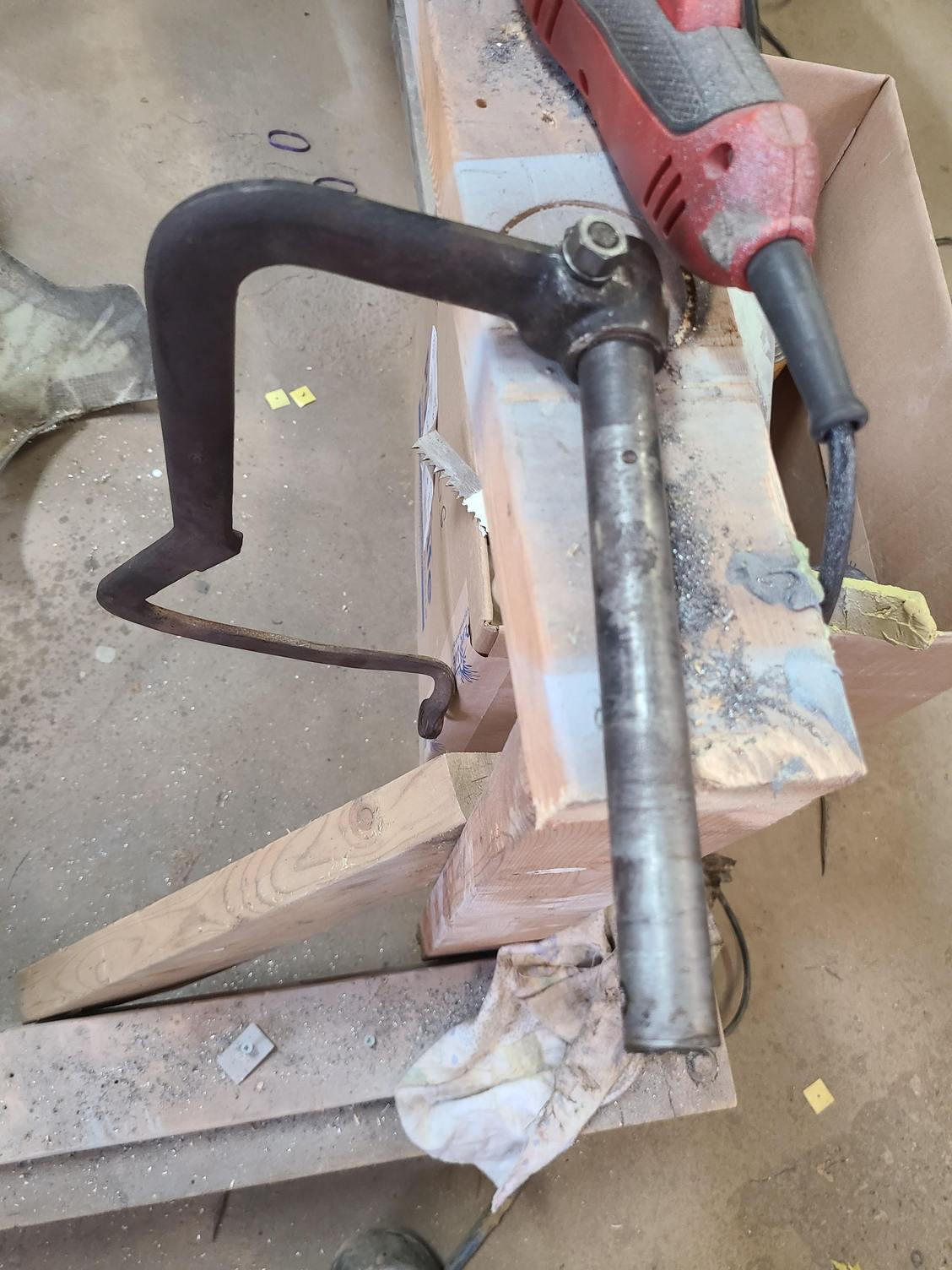

This is a pic of what I have. This may help. I don't have a clutch anymore. The finger points to the mount in question.

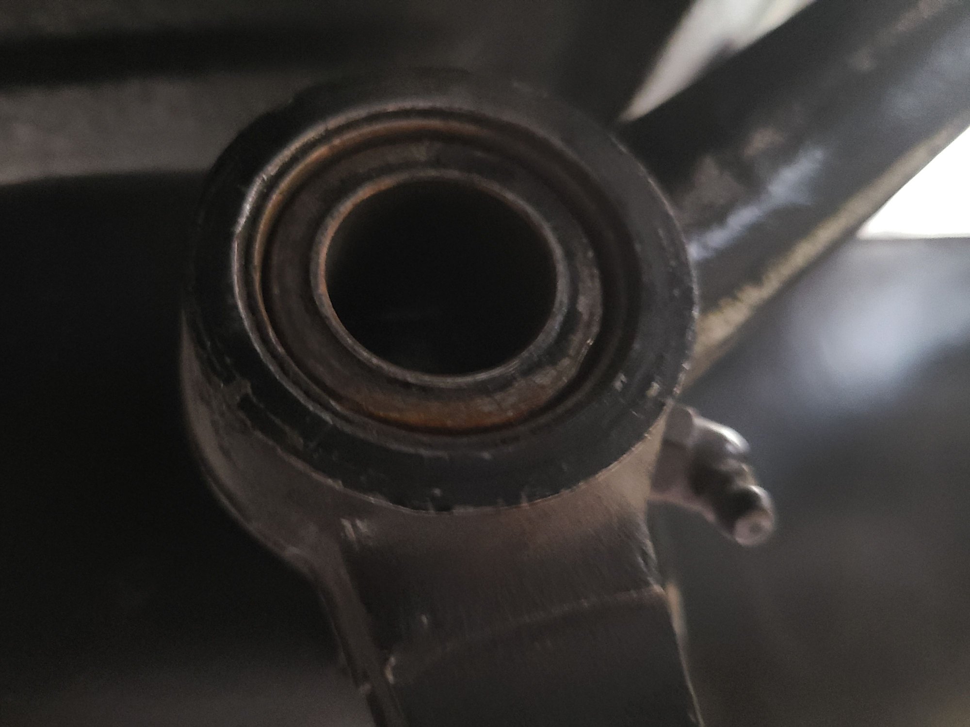

This pic shows the pedal arm, the bushing and grease nipple. I have pulled it out slightly from the frame mount.

Do you still have your clutch pedal and the shaft, if so you could cut the arm off and insert the keeper bolt 5782..

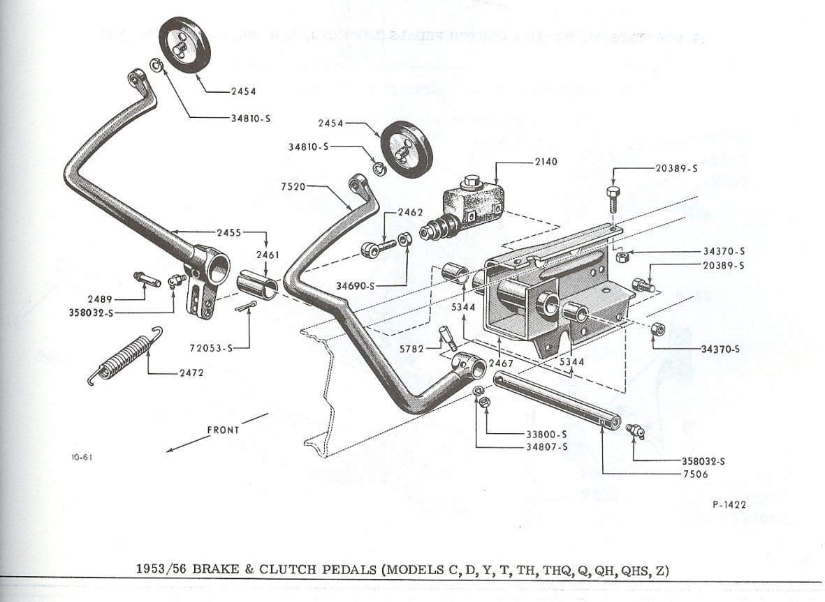

You need the non-clutch brake pedal shaft.
Here is the Mid Fifty version: 1953-56 Ford F-100 Brake Shaft, For Automatic (midfifty.com)

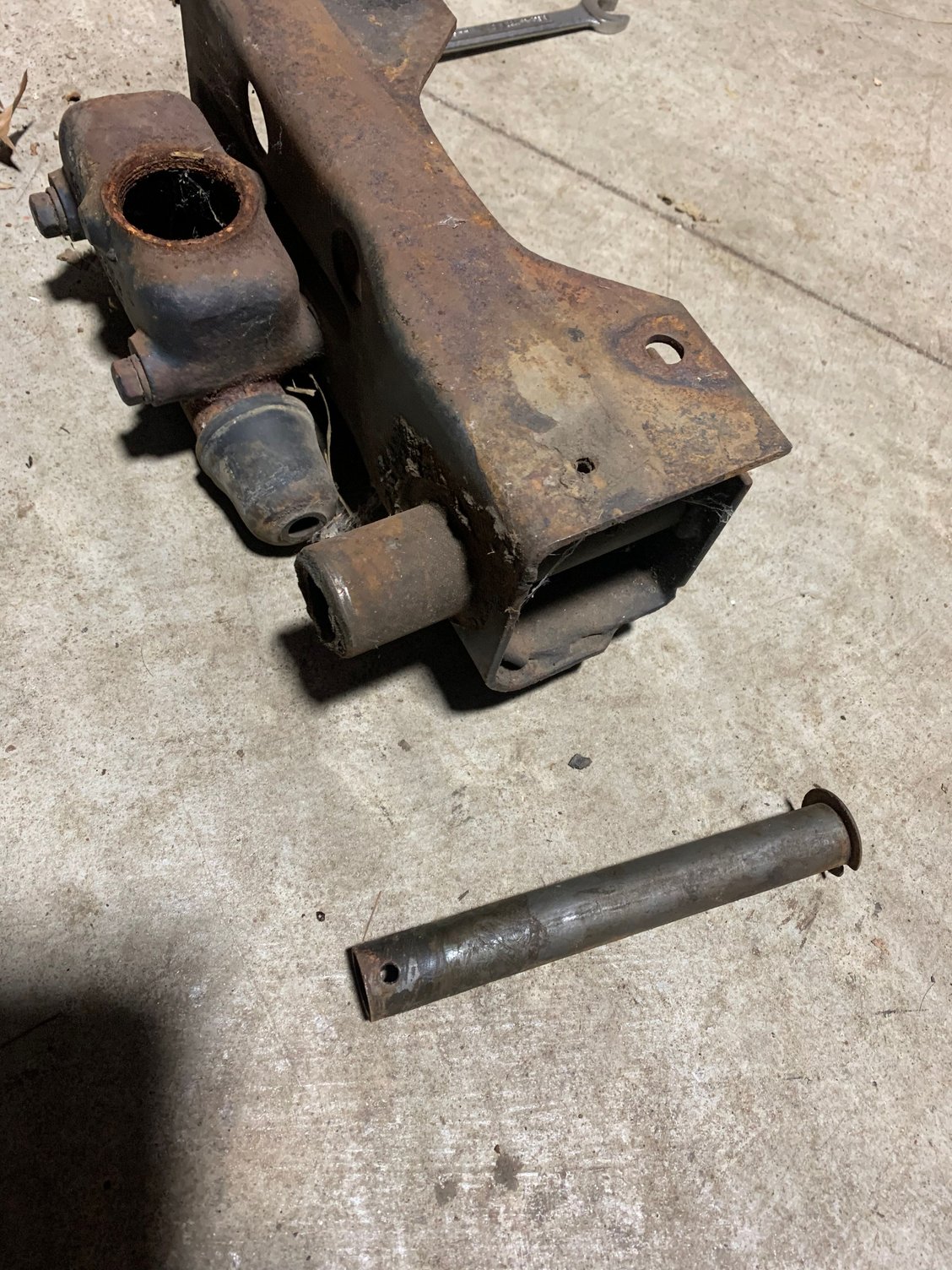

This is the “dummy” shaft from a factory automatic truck. It just had a large washer with a pin. But I’ve lost the washer

Thanks guys for the help. In doing some looking around the garage today I found this. I will cut off the clutch arm and use the shaft and the clutch part that attaches to the shaft. From there I will get a new washer and bolt for the other end. Success in my head anyway.
