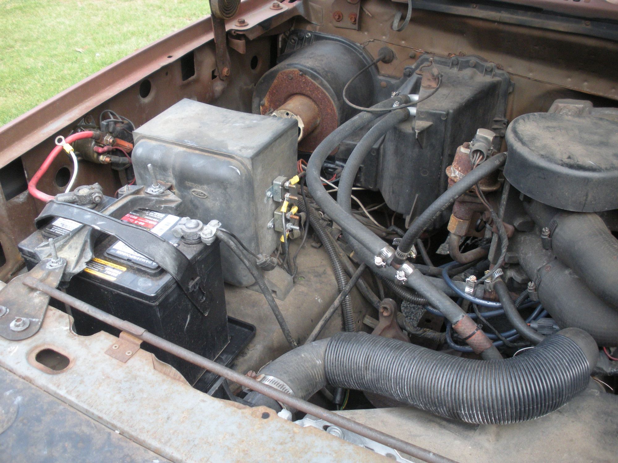

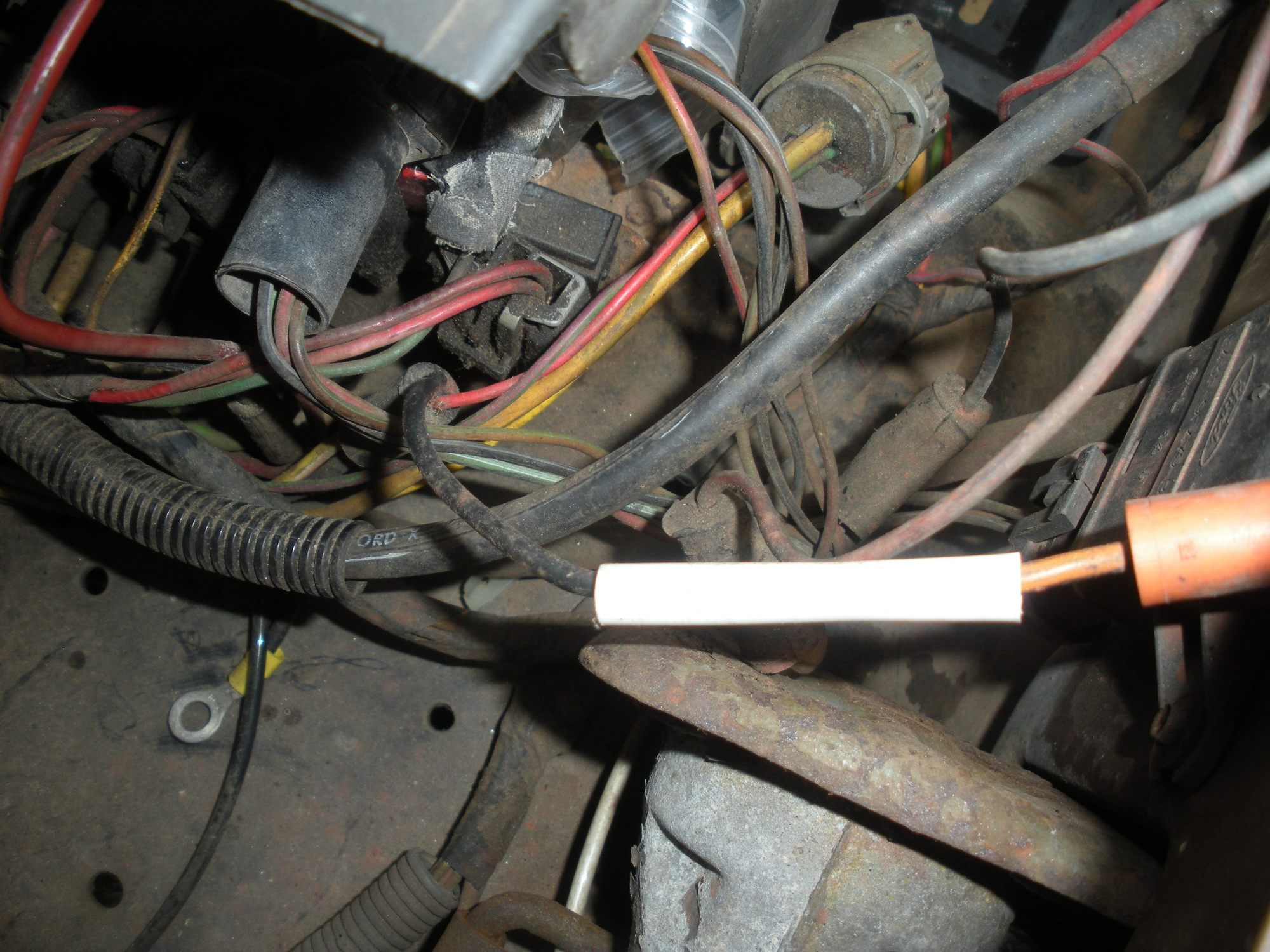

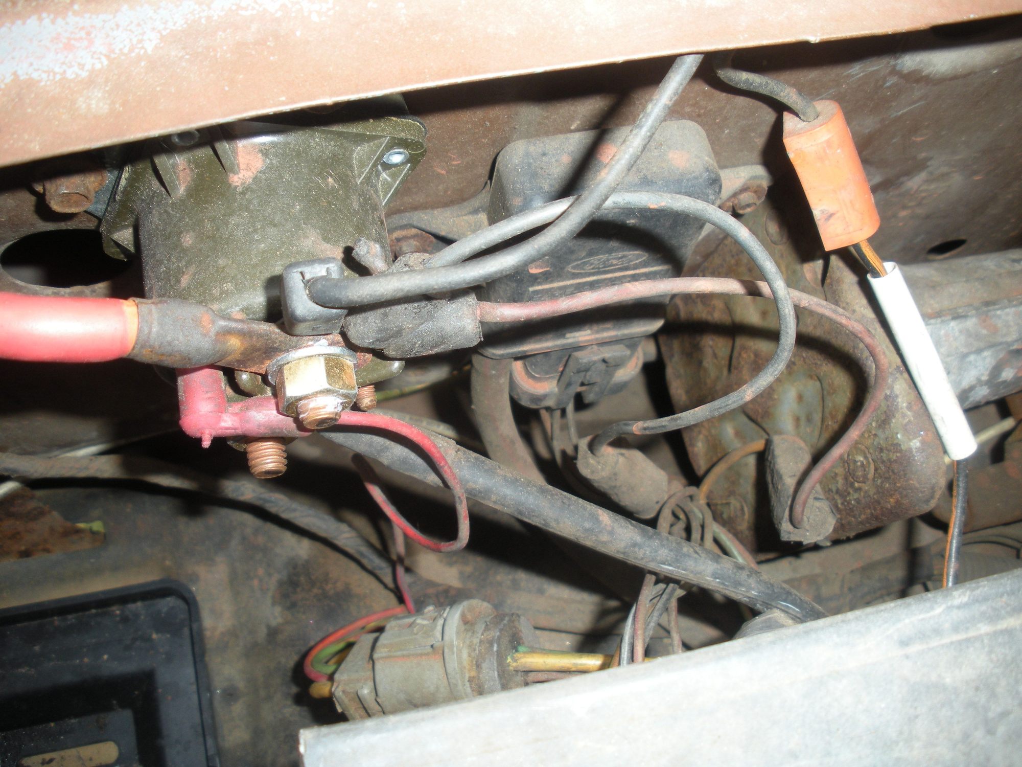

I have a 86 F150 with a 302 FI, but I went out and took some pictures for you, I've been wanting to get better picture to help others, thanks for making me get off my butt and do something... I took 8 pictures of that area, let me know you need better shots.

Fusible links to battery side
