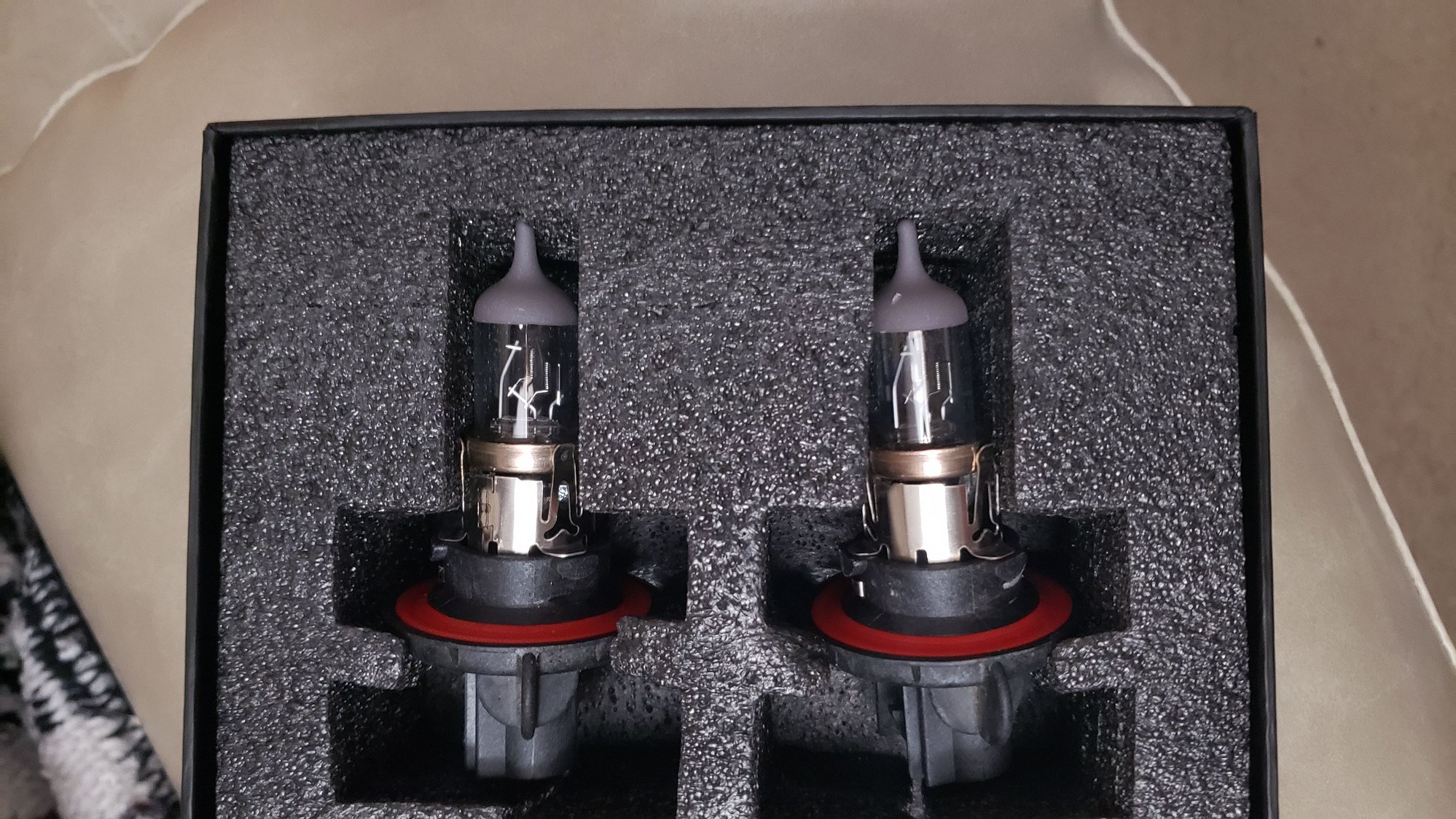

Sounds very strange. First question—what bulbs are you using? Second question—did you make sure to get all the orings out with the stock bulbs? They like to stick to the housing and you wouldn’t be the first to try to install new bulbs over old orings.

I think the brand is R&S, as far as the orings I'm pretty sure they all came out with the halogen bulbs. The LEDs were tight going in, but didn't have to fight them. The LEDs were $60 a set. I know they're probably not the best out there, but I've read about so many using Beamtech, $39 a set so I would think the quality would be similar. And besides the terrible beam patterns they just don't seem to be very bright. My brother in law has an '05 Dodge 3500. He has LED bulbs, on his passenger side the stock housing is pitted, faded, oxidized.. You name it. His drivers side outer housing is missing, and the inner reflector has been exposed to the elements for at least 6 months so you can imagine how non reflective they are and his LEDS are still brighter than mine with almost new crystal clear housings.

I went out and got the boxes.
Here's a picture showing the orings, and a picture of the brand of LEDs.

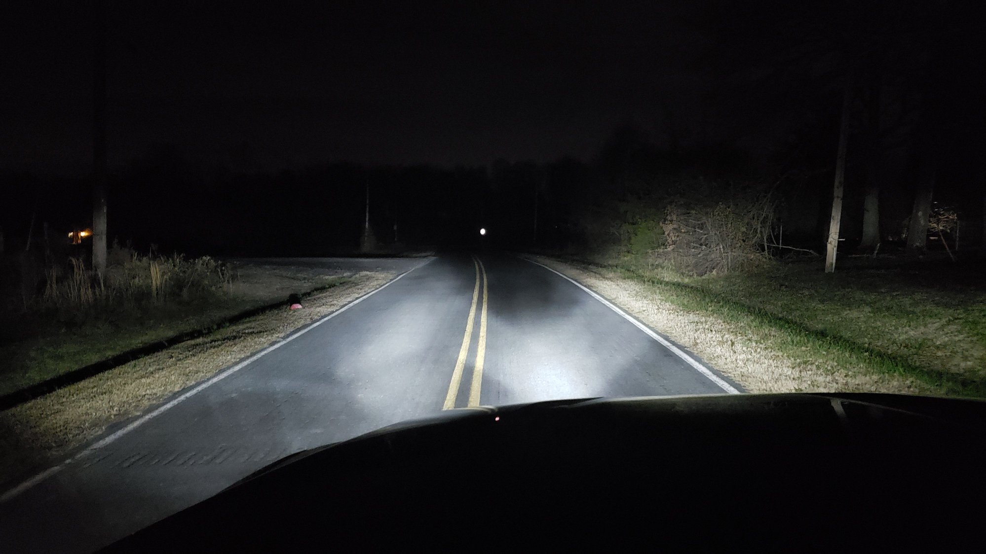

Here's a picture of the light pattern. The dark spot in the picture is closer than it looks. It begins about a car length from the front of my truck.

The beam pattern picture I posted above, looks like some sort of reflection but that's the actual light pattern.

Are those DOT certified housings? If not and you get the same light pattern just dimmer with halogen bulbs then the housings are the problem not the bulbs.

OK.. then the bulbs are the wrong type for those housings. Based on the light pattern it looks to me like the LED elements are in the wrong spot inside the housing, if you compare the LED and halogen bulbs side by side the LED diodes have to be in the exact same position as the halogen element front to back relative to the flange and also be clocked correctly.
