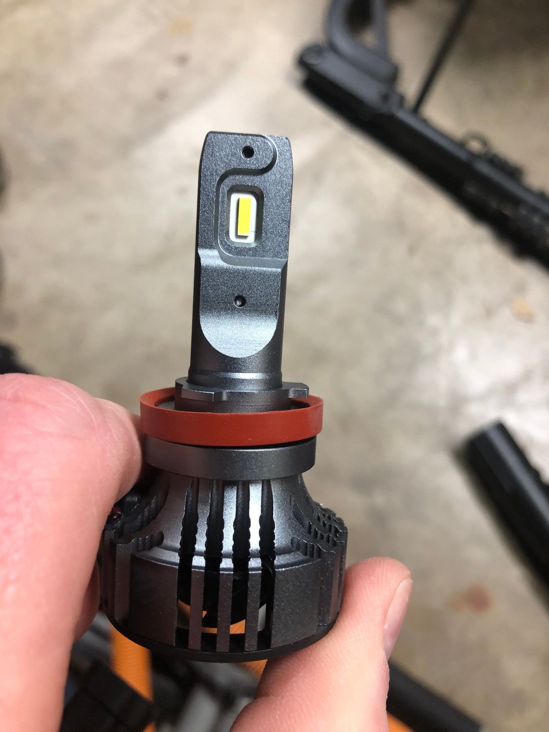

So is that an actual picture of your LED's?

Yes it is.

Those look like halogens? I wonder why they have a glass casing and painted tip like a halogen? This one is from my Wife's van but the ones in my truck are the same style. I'm gonna say send those back and get a different brand.

Sorry, when you asked if that was a picture of my actual leds, I thought you meant the picture of the lights looking out of the windshield. The halogens are what was in my truck, I just took that picture to show the post.. And myself.. That the orings came out with the halogens.

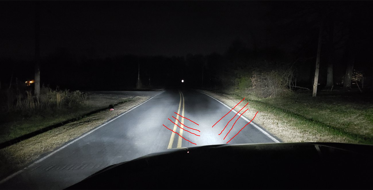

I'll put a picture up later today, I'm taking the LEDs out and reinstalling my halogens. The LEDs look so good in the truck, until you try to drive and see with them. I even used Forscan to go in and see if I needed to change anything to run the LEDs, but didn't really find anything.

This looks like it might just be an issue clocking the bulb, or with the placement (depth) of the bulb inside of the reflector. You can distinctly see where each diode is casting light outward in the picture posted, with none of the light being cast forward. The light on the driver's side of your truck is being cast by the passenger headlight and vice versa.
This is what I thought too.Looks like a clocking issue.

We were just out here checking, and they are 100% installed correctly. Clocked precisely at 9 and 3.
