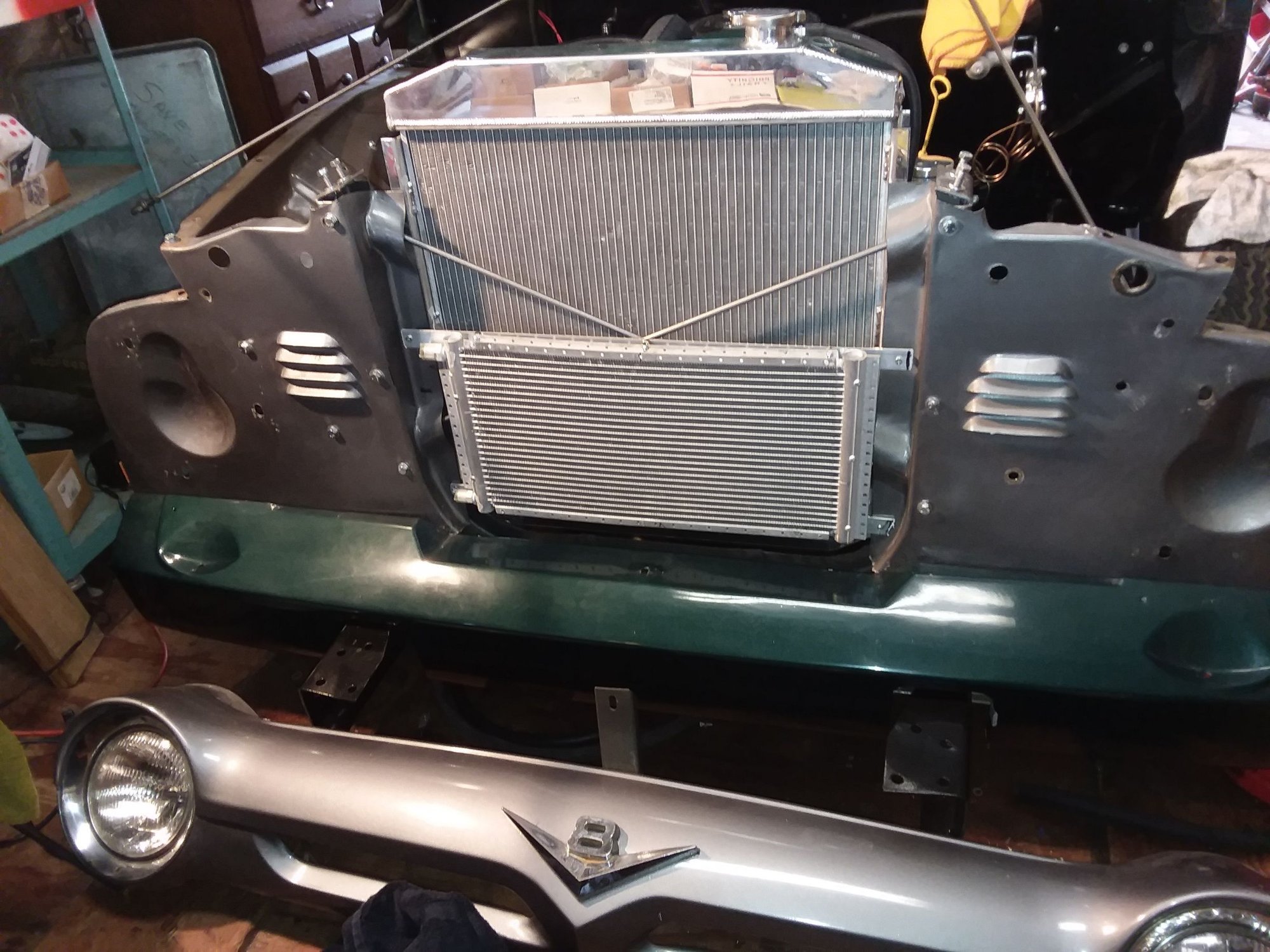

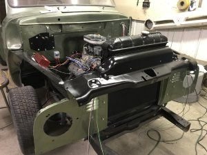

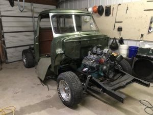

I don't know if it was right, but I installed in the following order:
Radiator support and radiator/hoses.
Air deflectors.
Inner fenders.
Hood latch panel.
Lower valance (gravel pan)
Grille.
All the wiring was installed at this point. I didn't install the doors or front fenders until the wiring was installed and tested.
Hood.
Fenders.
Running boards.
Doors.
The doors were last because nothing else effects them, and they are a pain in the knees, back, and elbows to work around.

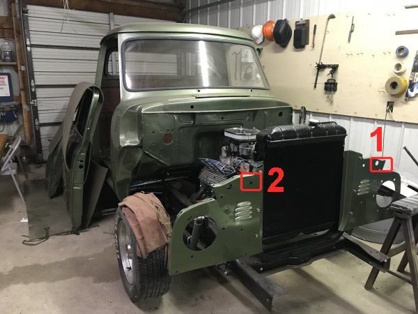

On the wiring question: The wiring passes through the left wind deflector through the hole marked "1" in the first picture below. Your deflector still has the grommet to protect the wires from the edge of the metal. From there the wires are split right and left. The horn wires pass back through each wind deflector through the hole marked "2". (Deluxe and Custom cabs had two horns)

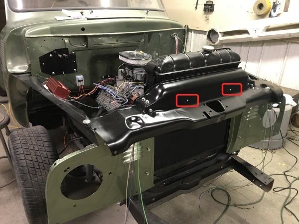

The wires crossing to the right head/marker lights and horn are held up by clips under the hood latch panel, in the holes indicated in the picture below. They were originally one-piece steel clips, but I used plastic straps held by stainless screws.

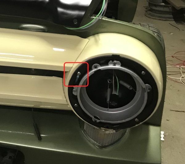

I had a grounding issue and added ground wires to each headlamp bucket, as shown in the picture below.
