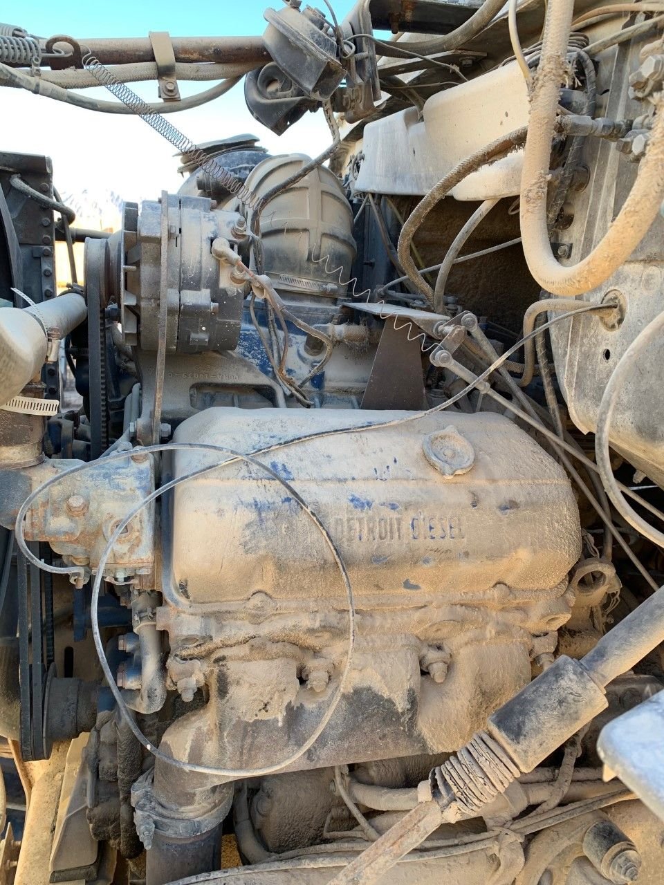

New member from sunny Las Vegas. I came across this forum trying to identify a water truck for my neighbor and thought I'd try my luck. I think it may be an L8000. Does anyone have any recommendations for service literature or know how I might go about identifying the year/engine/transmission?

A = Detroit Domestic Special Order. Your engine should have some identifier on it via a plate, decal, etc. If need be, you can post pictures and other members will help ID it for you.

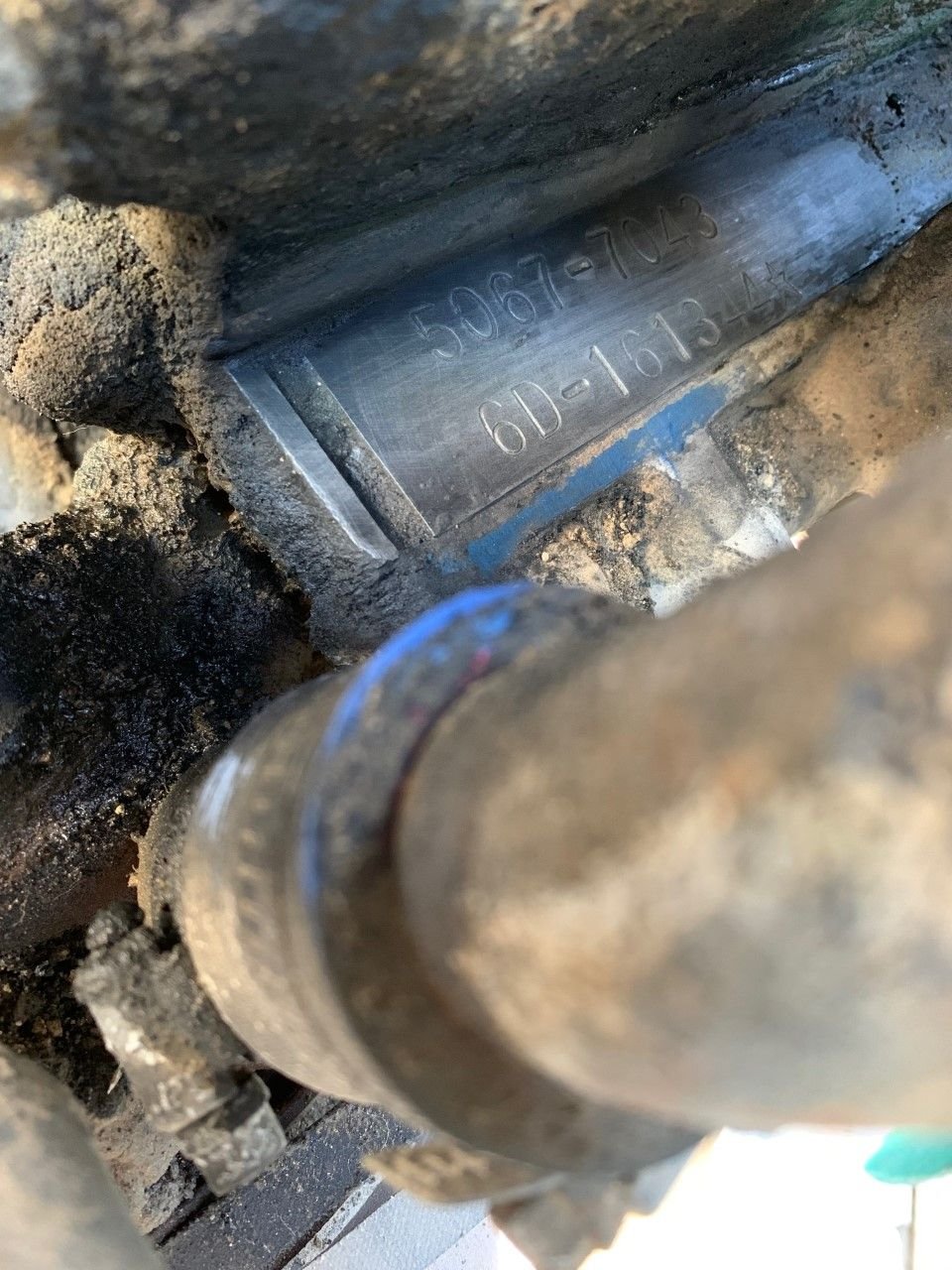

My buddy inherited this truck and asked if I could help him bring it over to his place. We filled the tires, checked the fluids and nursed her along with low transmission fluid and several air leaks. Never realized how much fun it would be to revive this old truck and bring it back to life. I've replace two new front tires and rebuilt the dash control valve for the brakes. My next step it to change the fluids and perhaps refurbish the radiator depending on what surprises pop up. I'll definitely check out the parts CD. Do you know where I might begin poking around the transmission for an ID stamp? Also, I'm a little confused on the vintage of the truck. Is it a 1973 engine in a 1979 truck (series number)?

Your engine tag identifies it as a Detroit 6V-53N, with a manufacturing date of 10/1977.
