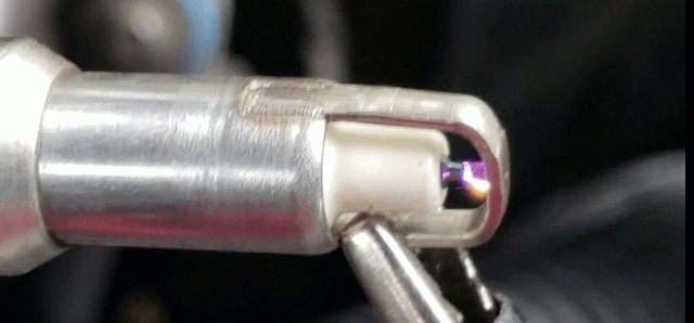

A simple test is to remove the offending plug - install an old spare plug into the cylinder temporarily. Connect the COP primary and Insert the offending plug in the COP boot. Ground the plug cathode with a jumper. Start the engine and try to get it to spark like it is supposed to.
