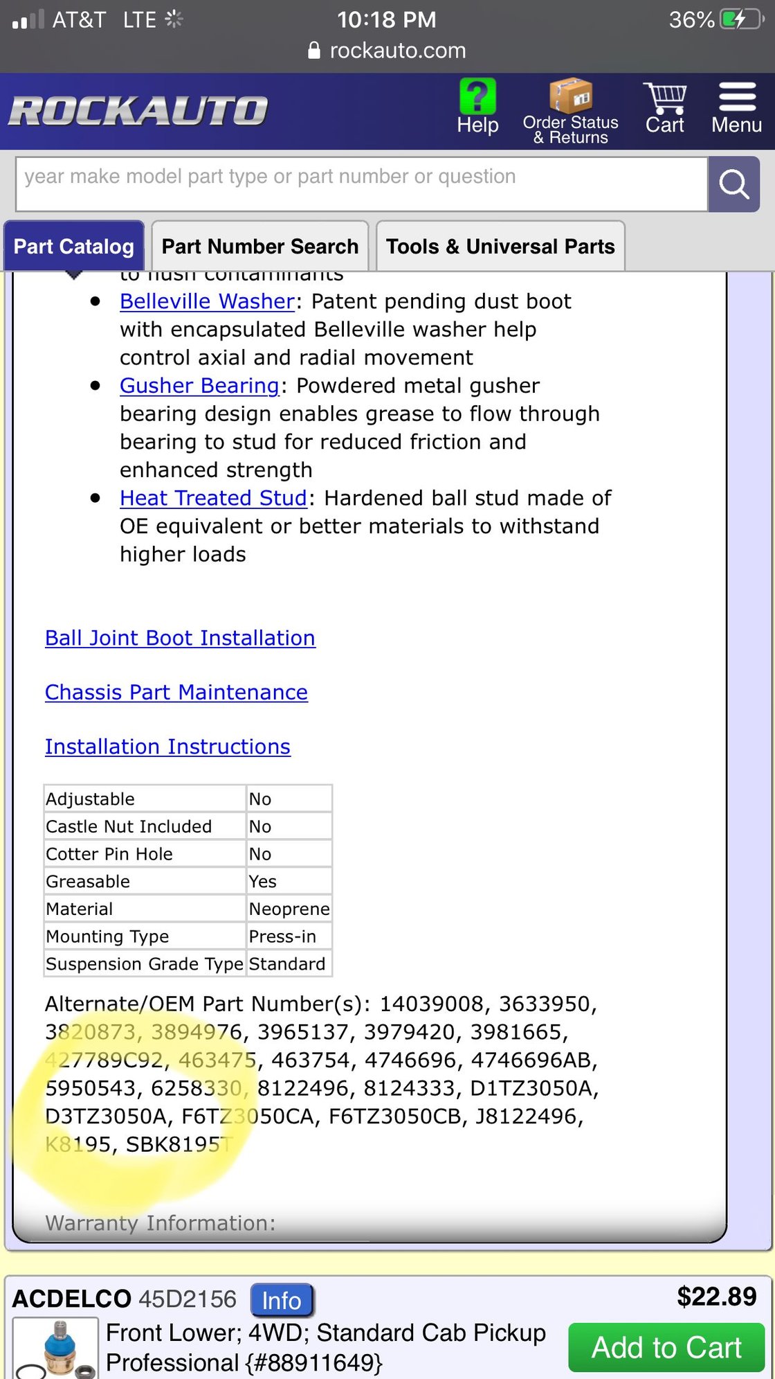

Looking for a set of NOS ball joints for a '76 Highboy with a Dana 44. Part numbers I came up with are D3TZ-3049-A and D3TZ-3050-A. Green Sales lists them, but I called and they are Moog parts. Google isn't a whole lot of help. Does anyone have a list of newer and older substitute part numbers I can search for?
Tired of changing junk Spicer and Moog joints, would like to try a set of factory Ford.

Numberdummy or Jeffaffa are the only ones I can think of. I am surprised that Green Sales didn't have the cross reference already?

Moog K8195T is alternate number
Myself I’d be buying Spicer if possible.
