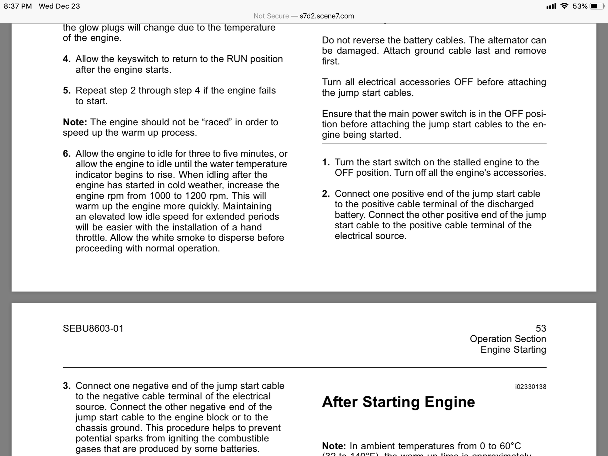

I do a warm up. I was taught over 50 years ago to do a warm up with a diesel. I’ve read that in just about every diesel owner’s manual in the commercial, agricultural, and industrial field. I remember reading Ford altered the programming for the 6.0 to reduce power output until warmed temps to help the 6.0 with the head lifting, head gasket issues considering the situation.
My understanding is the thermal expansion of the head improves the sealing of the head gasket for one, and with a 6.0, I could stop there.
This is basically what I follow.
Have I gingerly idled up the street during the warm up, yep. After 2 minutes of sitting. I tend to not move the shifter until the glow plugs are totally off under any conditions.
The only owner’s manual reference I can easily grab is one for a Perkins diesel, I have one in my chipper.
An old dog, no new tricks.
