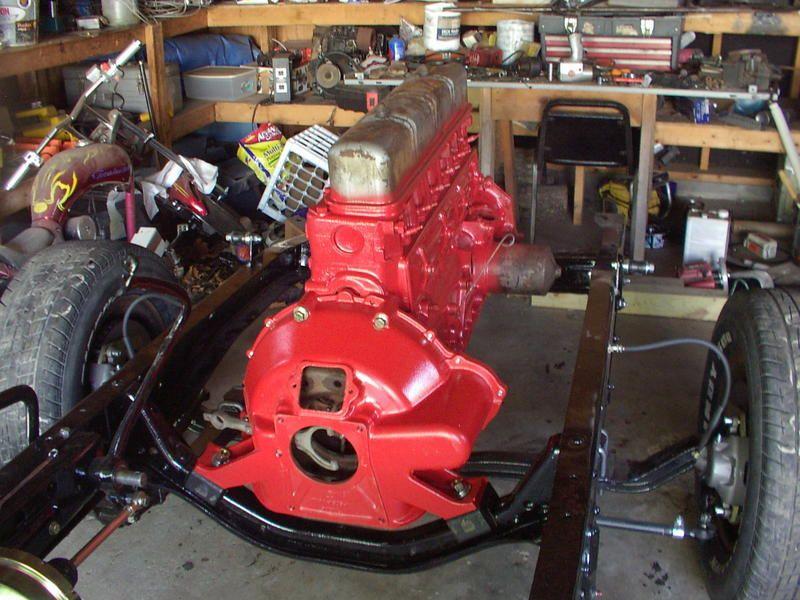

My 54 has the 223 instead of the 215, but the bell housing should be the same

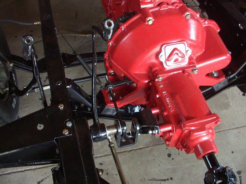

Great picture Indybeer. Seeing that, is the transmission bolted to the bellhousing from inside the bell? Or are there flanges that allow the trans to bolt to the bell from outside?
If they bolt from the inside, you will have to take the bellhousing off. Support the rear of the engine before you break it down.

Studs screw into bell housing.
