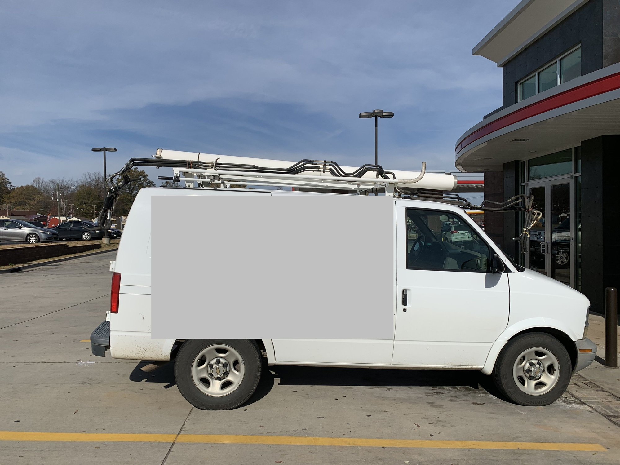

Here they are, a set I pulled and had for sale, but decided to keep.

Since I bought my X Feb 2016, I have been replacing everything that needed some sort of attention. I have been fortunate that I've been finding mostly NOS parts from my dealer, and other dealers. I've been on top of junkyard items too, but I have been watching all of the Ford NOS stuff going discontinued just in the past 1-2 years. I'd like to keep my truck a little while longer, so I hit the U pull it's when they have X's on the lot.
Brought that thing home on a spare service van from a couple hours away.
