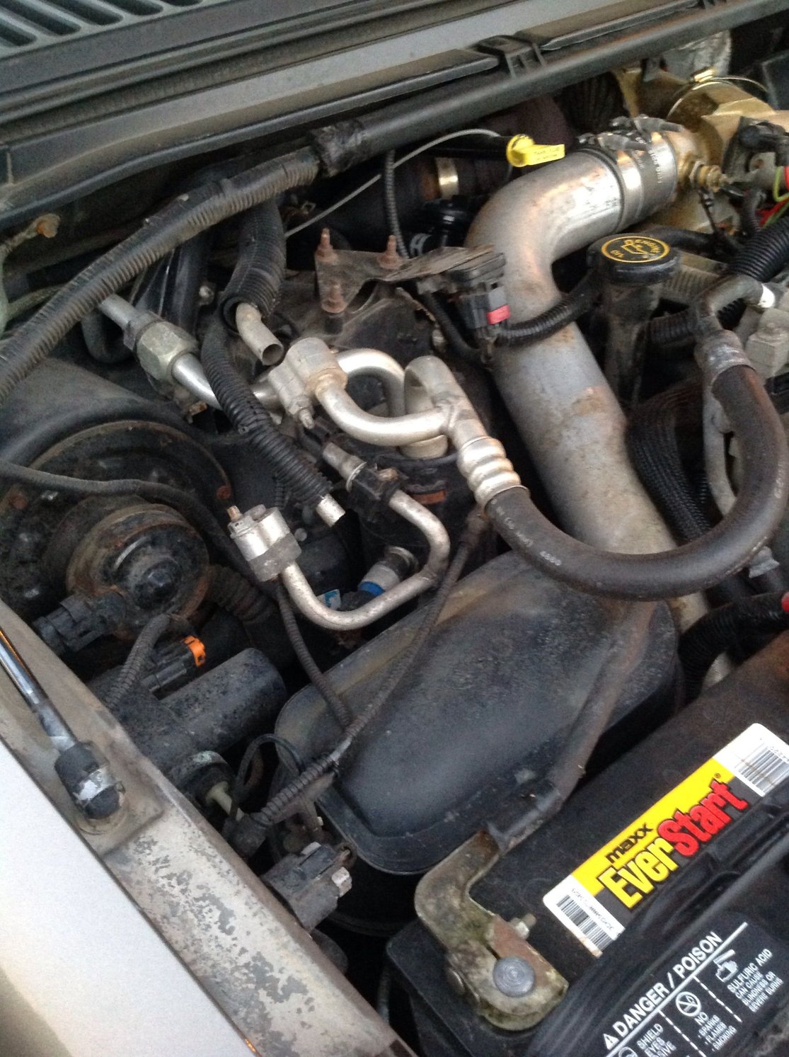

I assume your front AC still works? If so, it sounds like they used truck lines up front, as the Ex (with rear AC) hoses split for the rear AC. If this is the case, you'll need some hoses up front, and will need to reclaim the refrigerant to switch over.
Nitrogen is commonly used to leak test AC systems, as it's a somewhat inert, non-flammable gas.
I'd search out some Excursions in the salvage yards to see what you can get. A rear evaporator from a salvage vehicle will probably be fine. You'd just have to inspect the hard lines and see.
An A-C O-ring kit is less than 10 bucks at Rock Auto- and the connections where these O-rings are used make up a majority of automotive refrigerant leaks. My opinion is- if you have to open the system anyway, why not re-ring it since it's so cheap?

Photo of lines underhood
Here's where they deleted the lines to the rear ac. Yes my front ac works great. But 95' days it's slow to cool down that big interior.
Ok so I really have no idea how these lines fastened. Were they a compression fitting?
Ultimately I would like to find the leak. Replace any bad part s or use a splice. Then finally flush and recharge?
