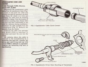

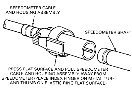

Just do all the lights. I don’t know the code for them off hand but google is your friend. While you’re in there, get the headlights/swiper bulb on the left side, and the heater control illumination bulb on the right side. I think you can just reach into the right side of the dash to get the heater bulb, instead of taking the whole thing out. It plugs in the back behind the face of it.
careful when taking the black outer trim piece off the dash, the headlights/wiper light is plugged in on the back. You’ll have to disconnect your speedo cable from the back of the cluster, to do that unbolt the cluster and gently pull it forward 1/2 inch or so. It won’t do very far. Then stick your arm in from the left and feel the big cable coming out the back of it, tilt the plastic collar and slide it back. Super easy once you do it once.
