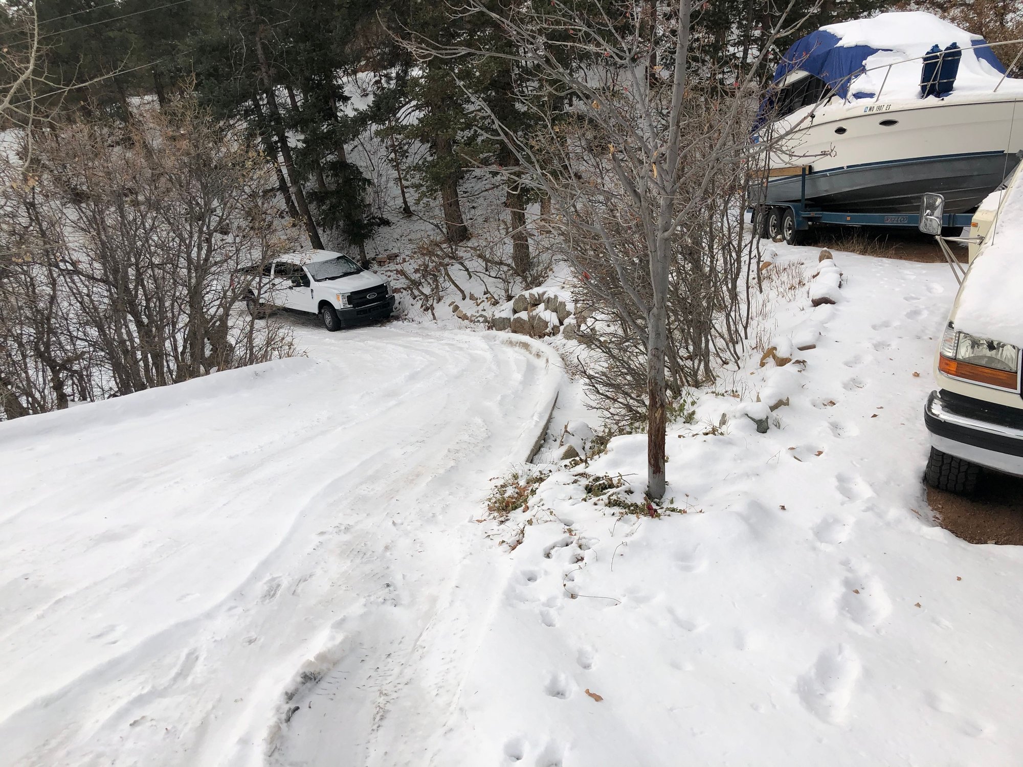

The other night I was heading home in a snow storm and I live in the mountains. With steep grades and roads that the city doesn’t plow ice accumulates pretty easy. The snow will melt a little during the day then refreeze again at night. Add more snow on top and it’s near impossible to drive on. I was heading up the mountain and up my driveway in 4wd when I heard a dramatic pop half way up and I thought I broke my t-case. The truck then went RWD and lost traction. It then began to slide backwards and into the rock wall next to my driveway down to the bottom of the hill. When I was sliding backwards I threw it into reverse to try to gain control on the way down but the driveway was like glass and I was just along for the ride. Of course the side of the truck hit all that so I was completely livid. I was so pissed about it that I left the truck at the bottom of the hill in disgrace and walked home.

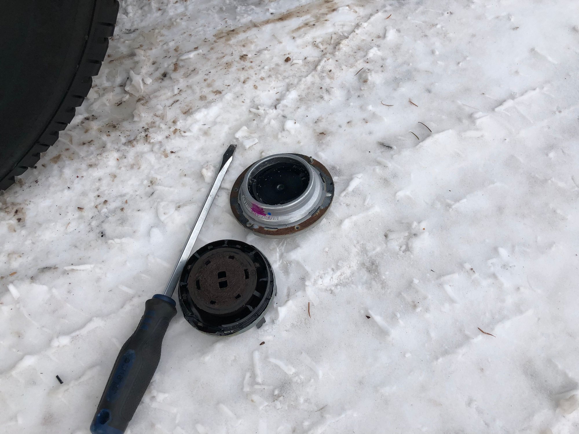

The next morning I went back to the truck and was unable to get it up the driveway and was stuck in the valley below. The truck is worthless RWD and wouldn’t go anywhere. I found what broke was not the t-case but the front wheel hub lock on the passenger side. Took it apart and was pretty disappointed about how weak that system looked. The whole unit disintegrated in the hub. Bearing rollers, plastic parts, springs and clips all mangled in the hub. It took over an hour to fish it all out.
Took it apart and found a way to piece it together to allow power to the front so I could get it home.

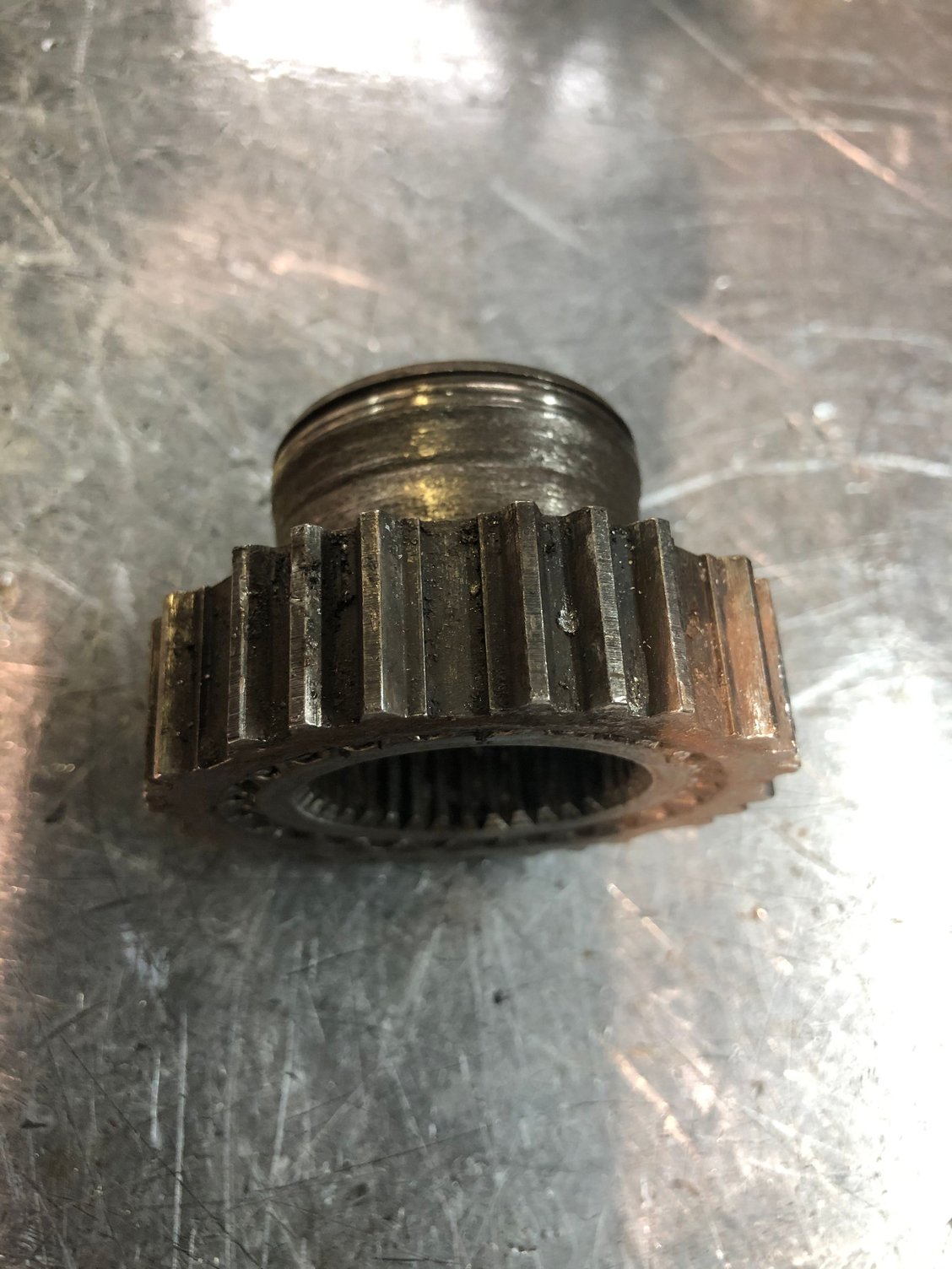

I took the 2 pieces below and put them together. The top piece splines on the shaft and the bottom piece splines into the hub. Locked together they transfer the power from the shaft to the hub.

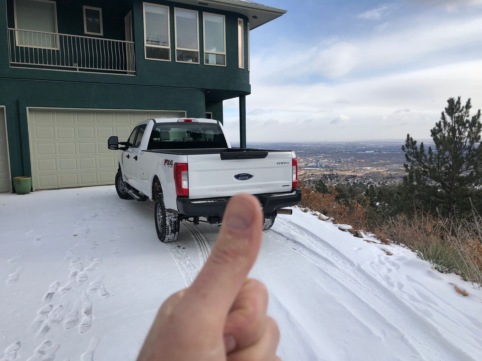

I then put them back in the hub (after I cleaned the hub out) so I could get 4WD power back just to move it a short distance. This worked and the 2 pieces never popped apart. As long as the load was applied and consistent they never popped loose. It made it all the way up the hill just like in the pic below.
After that worked and I got the truck home I thought that I could clean those pieces and weld them together to make an emergency lock if I break another in the future. I figure it will likely happen again because the design is very flawed so might as well be prepared. I also welded 2 nuts so I can attach bolts to it to make removal and install easier (don’t have to fish it out with a screw driver). Polished it a little and tapered the splines to make install easier too.
Slides in and out with ease using the bolts as leverage.
