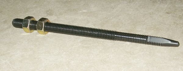

the one piece rod I have...so nuts should be tightened toward the tip?
2 piece I don't have

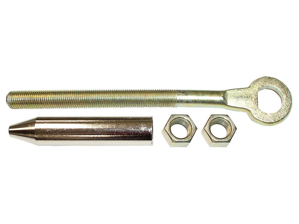

That's not the right rod. I'm not even sure how that would work , what connects it to the Z bar ?
I'd get the correct 2 piece adjuster and see what you can do with it. chances are that's your only problem.

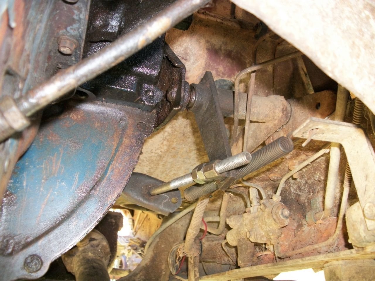

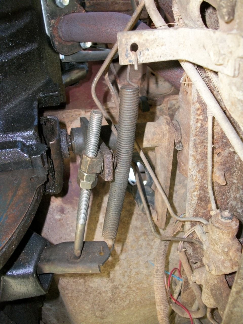

We have the same adjuster on ours. Replace your linkage rod bushings and see if the helps. Ours were completely gone giving a decent amount of lag before Z-bar engagement.
Here is how the adjusting rod connects to the Z-bar.

Thanks, John. This is the assembly I have. I definitely will check bushings. As I said in my first post, if the nuts are on the end farthest from the tip, there is no more adjustment to be made? Is this correct? Should I replace the return spring while I'm at it?
