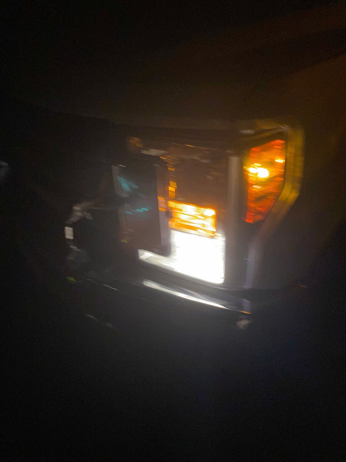

I installed the 16071200a adapter for Ford 250-550 2020+ w/halogens harness onto my 2016 truck-side wiring. All the part numbers were the same so I just pulled the wiring from my tundra that I traded in and installed it on the F350. I have halogen housings with GTR led bulbs. I am experiencing the same problem, I did find some corrosion on the truck wiring plugging into the headlight bulbs, cleaned that with no success. Started messing with the truck side plow wiring and I can get passenger side upper bulb to flicker but not stay on, driver side upper bulb is out. I've swapped everything to troubleshoot, all bulbs work. I think there is bad contact somewhere between 16071200a(new harness adapter) and the original truck side plow wiring. Does anyone happen to know which color wires control the upper bulbs? I will be investigating further.

Got back to messing with the wiring today to see if I could determine an issue somewhere. After emailing a rep a few times and confirming what I did was correct, and playing around with Swapping relays from one connection to another and getting varying reaults I boiled it down to 2 things-relays or relay box. I think it may be both for me. My box is 6 years old and shows signs of corrosion, and naturally the relays are also that old and also have corrosion.
I ordered a dozen relays to replace the 6 in the box and have 6 backups. Ill see if those do the trick on monday, if not then ill order the vox and that will be that.
