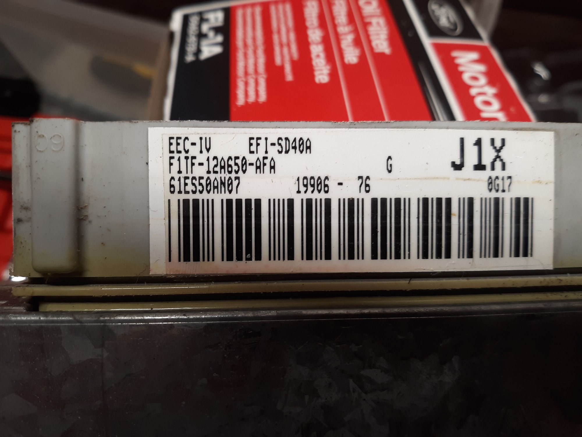

Originally Posted by subford
With the calibration number of 1-51R-R00 your PCM (EEC Computer) should have the number "F1TF-12A650-AFA" on it./
I was able to pull out my PCM this morning right after I got off work. It does match the number above. Here is a picture.
