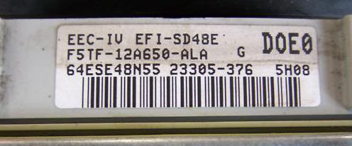

With the calibration number of 1-51R-R00 your PCM (EEC Computer) should have the number "F1TF-12A650-AFA" on it.
In the image below yours would have the number "F1TF-12A650-AFA" in place of the number "F5TF-12A650-ALA".
Attachment 280788

As stated, it is on the computer. You would need to remove the computer to see the engineering number which can then be used to determine the part number.
Yes the computer may have to be removed from the drivers kick panel to read the engineering number.
