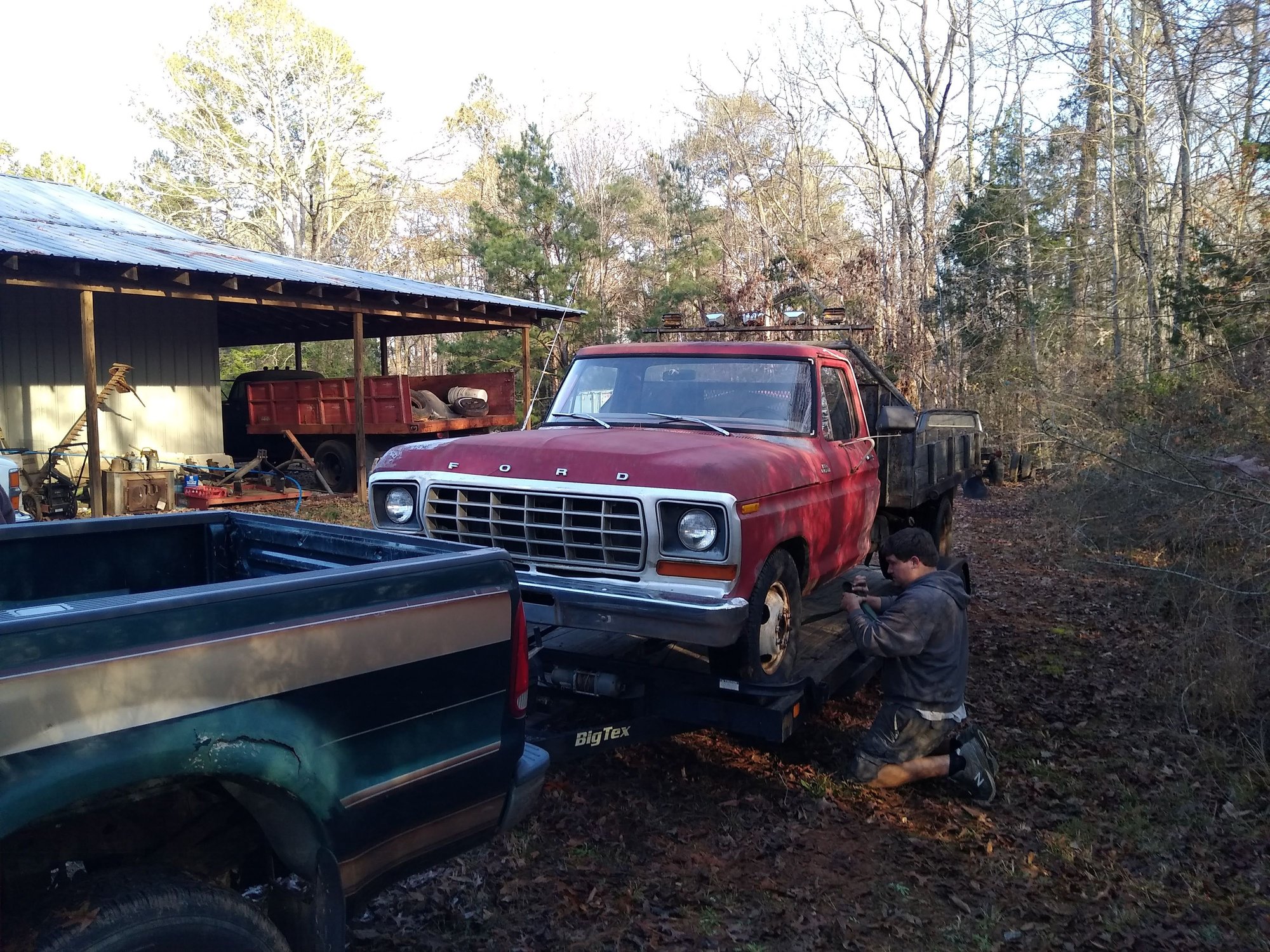

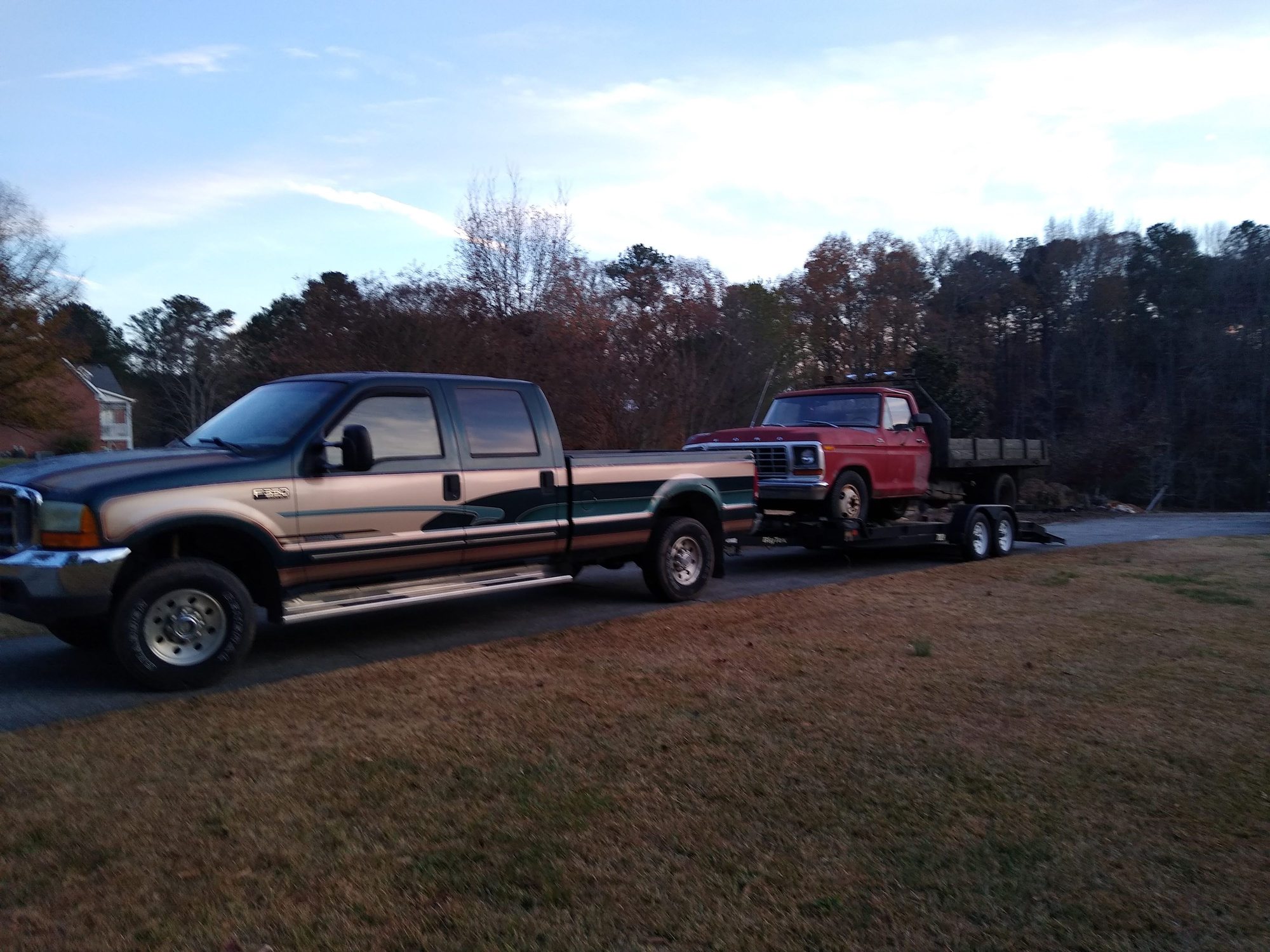

Brought this home over the weekend. I've been working on it at a friends shop. It's a 73 F-350 with a 390 and a 4 speed, but with a 78 F-100 cab. I've replaced the calipers, pads, rotors, brake hoses, 1 brake line, master cylinder, rear hardware, rear shoes, wheel cylinders. I've bled the brakes quite a bit and I think I got all the air out of it, but there is a ton of pedal travel before anything happens. I'm thinking I just need to adjust the rear brakes up a bit, but I wasn't sure if there was something else I may have missed. The old master was leaking into and all the other brake parts were frozen or in bad shape.
