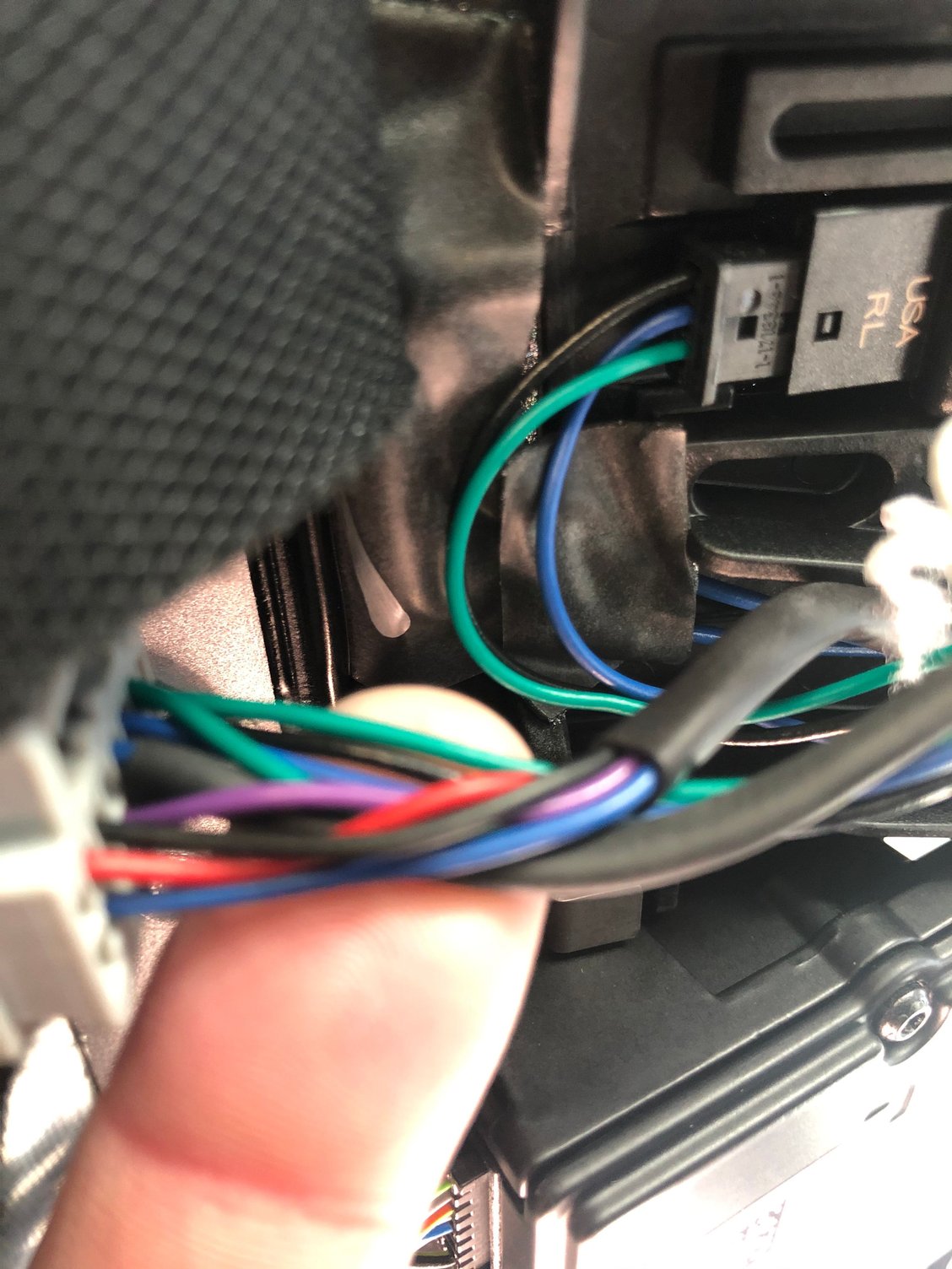

Alright good info here. I just bought one of the pin tap pig tails from Amazon. Seems the cleanest way to do this without messing with the factory wiring. These should plug into the back side of the connector without damaging any wire insulation. I'll take some pics and update on my install. From my research there should be a solid yellow/+ and a black/- leads in the harness under the cover to the powered mirror.

Ordered Mirror Tap off amazon. Under that top cover there is a white plug and a black plug. Unplug the white plug. Orient it so that the black wire is on the left and the black wire with purple stripe is on the right. Your ground is going to be the black on the left. Your hit wire (when engine is on) is going to be the solid yellow, which is the third from the left. Wires should look like this:
Left to right
Black
Yellow/Gray
Yellow
Blue
Blank hold
Black/Purple
Mine has been using the Mirror Tap for years now. Took it out last night and took a picture of it to install in my 2021. Great little product that mirror tap has.

So I got my windows tinted today. While they removed the rear view mirror I had a chance to remove the cap cover and expose the wiring pig trail. No yellows in this bunch.
