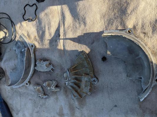

Originally Posted by BBSlider001
Yeah, soooooo, I beat my turbo to death. LOOOOOONG story short, I had enough.....LOL.
I have a temper....no shame.....is what it is. New one on the way.
Quote/image source= Hammertime...
It seems that the "hammertime"...
...may have been a blessing in disguise for BBSlider001 since he recently reported...
