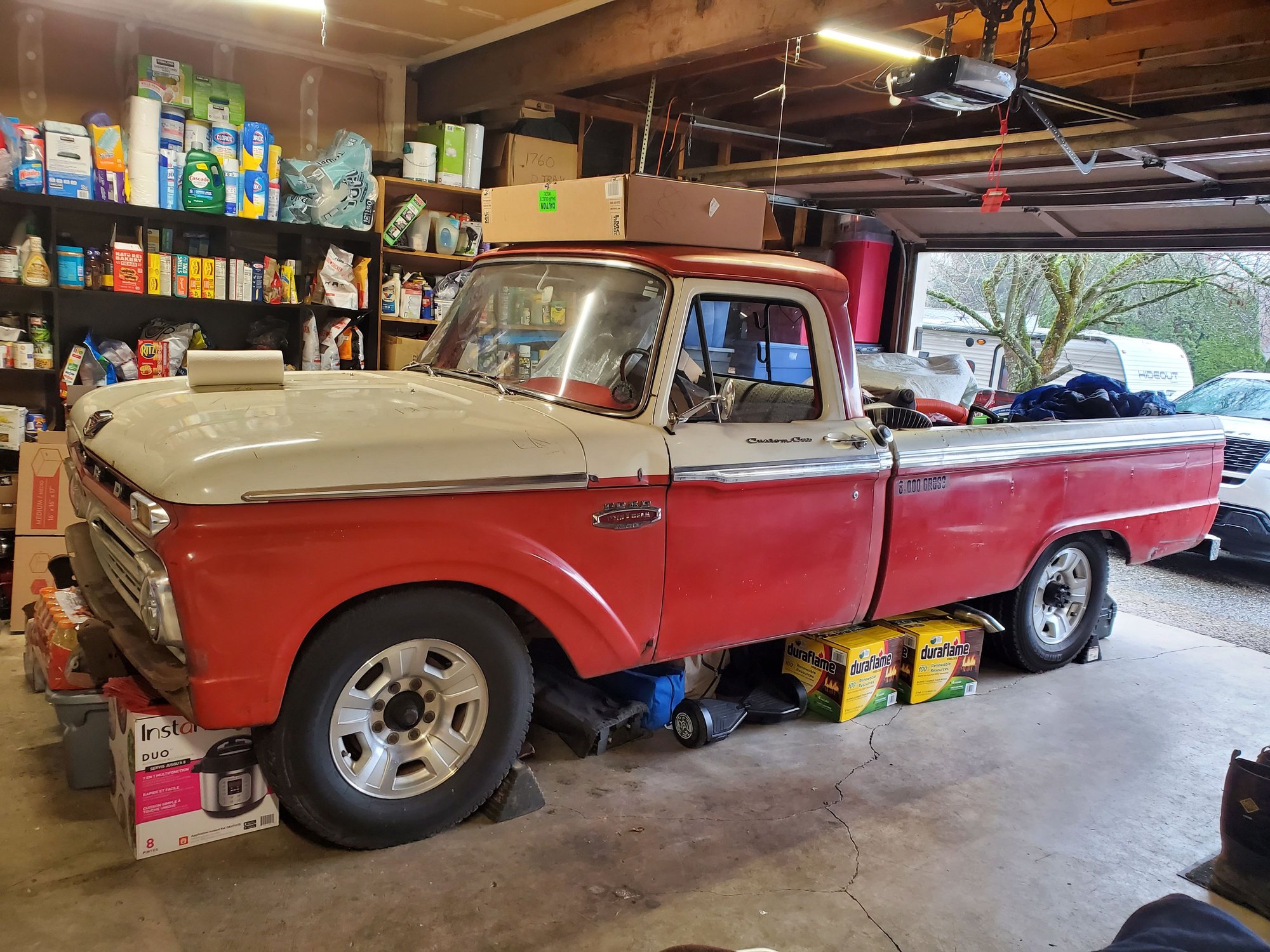

Here is a picture of the old noisy girl
Here is a picture of the old girl while she was getting some new fender flares

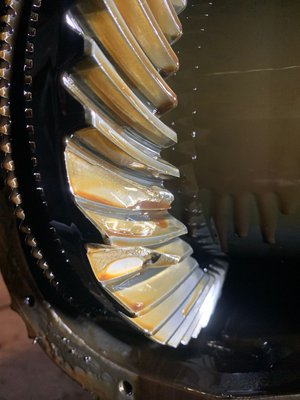

Put your phone in a holder and record a video while driving so we can hear the howl. Position the phone so it is recording the speedo as you are doing this. Since you mentioned tire howl, what tires are you running? Trying to tell where a noise is coming from inside the cab is futile. I had a thump-twang noise that I swore came from the front of the truck. It turned out to be broken gear teeth in the rear end.

I like your truck!
I also like that not-so-organised-garage too...

Organized chaos
Originally Posted by FinnishStroker
I like your truck!
what do you mean? Everything is where I can't find it haha plus this takes up all my extra space
