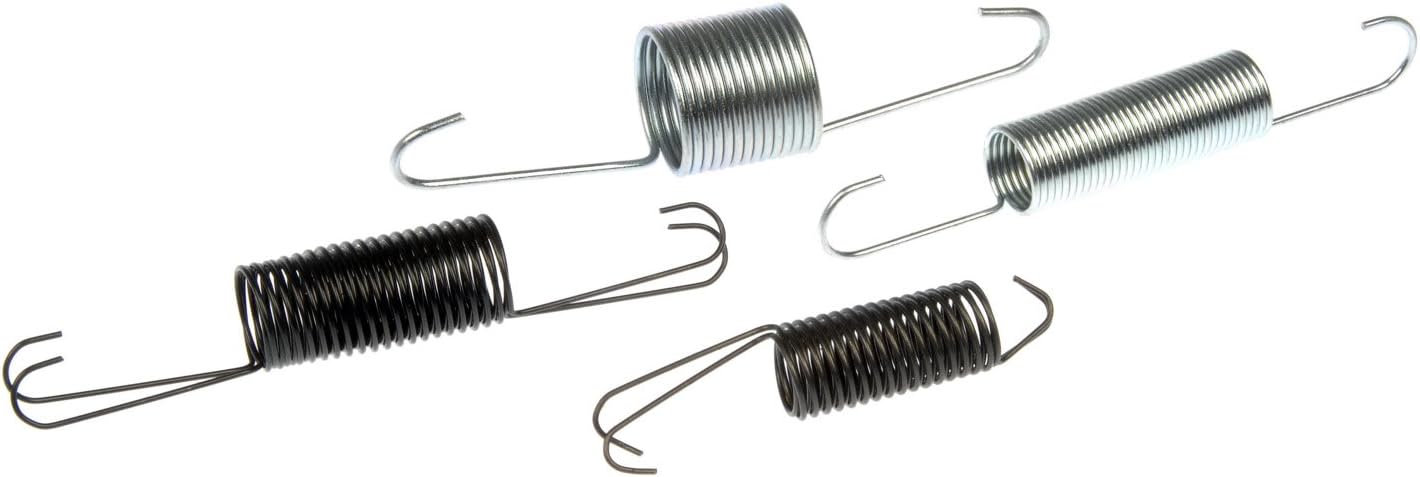

Check the Dorman catalog abe, they have all sorts to choose from..
