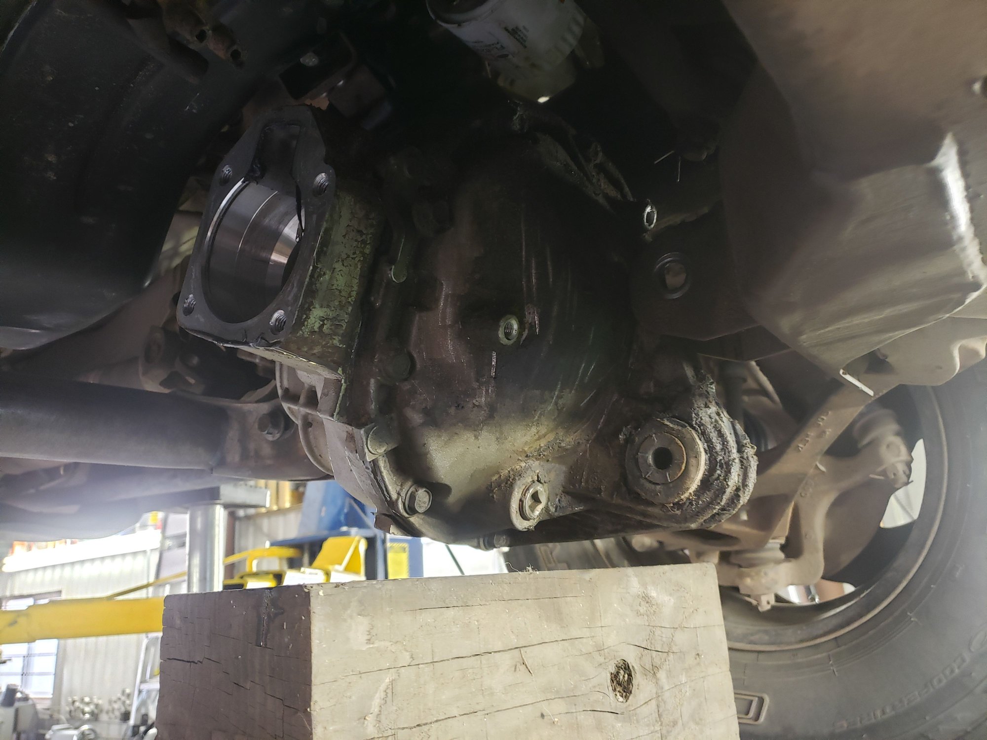

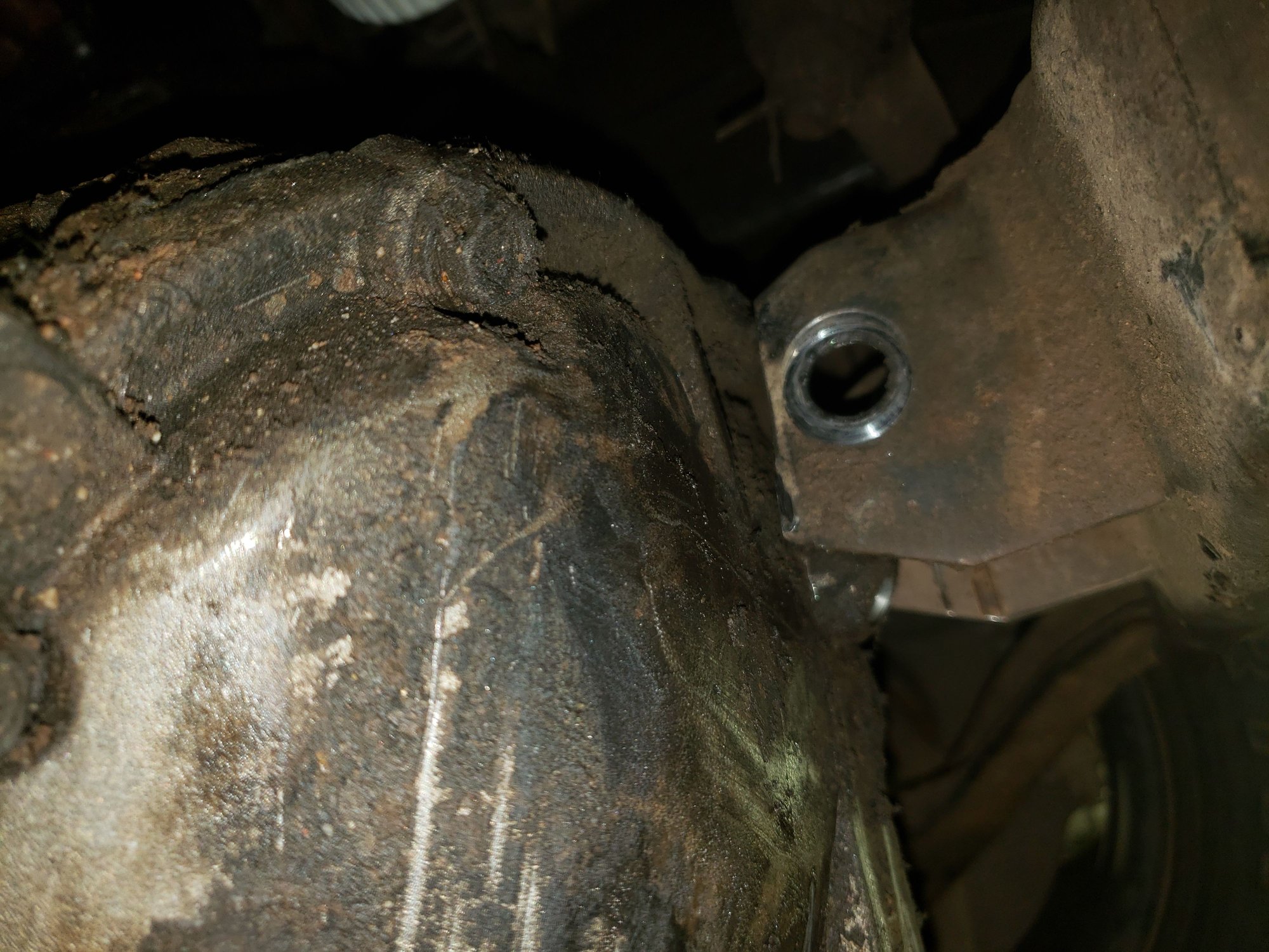

Another little tech tidbit: if you pull the FRONT bolt for the diff, loosen the rear one and remove the d/s you can tip the whole pumpkin down for less interference w the RH CV flange (RH shaft can stay in place). All that i learned from a brief YT video.
But what I found was that it's still a battle with the axle flange. The pumpkin will only swing down so much before the diff cover augers into one of the mounting tab ears. I shortened that ear with a cutting disc and now the diff will drop until the LH shaft rests on the A-arm. Should make reassembly much easier.
Ear hits diff cover and prevents further down travel

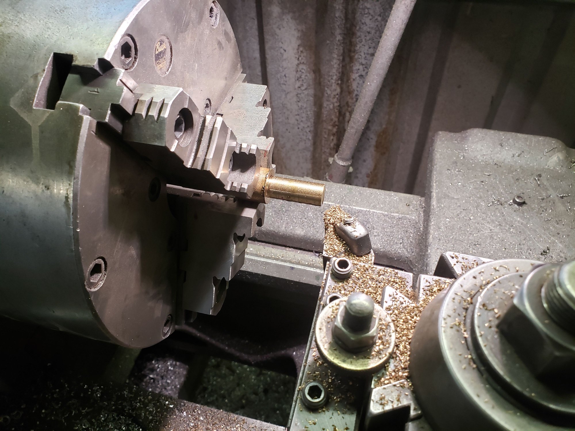

I decided on a slightly different approach than the thread I linked above. I may or may not regret it.
I tapped the fork 8-32. If the bushings want to try to spin in use this might cause one of them to back out, but I did assemble with COPIOUS red threadlock 'cause I really don't want it moving
Then I found a little drop of what I ASSume was oil impregnated bronze 'cause it noticeably leached oil while turning. I opted to make my bushings .200" thick with a .520" OD. I thru-drilled .171" and counterbored for an 8-32 SHCS .170" deep

Confirmed, getting the front diff to swing down as low as possible is well worth it.
Otherwise, put it back together 100% and the shift fork appears to operate perfectly when I apply vacuum to the actuator in either direction. I topped off front gear oil after it was buttoned up because I feel even a thin film of lubrication on that fork and collar will help with longevity.
Front pumpkin dropped as low as it will go after cutting mounting ear and CV axle held against frame w bungee cord makes for easy installation
