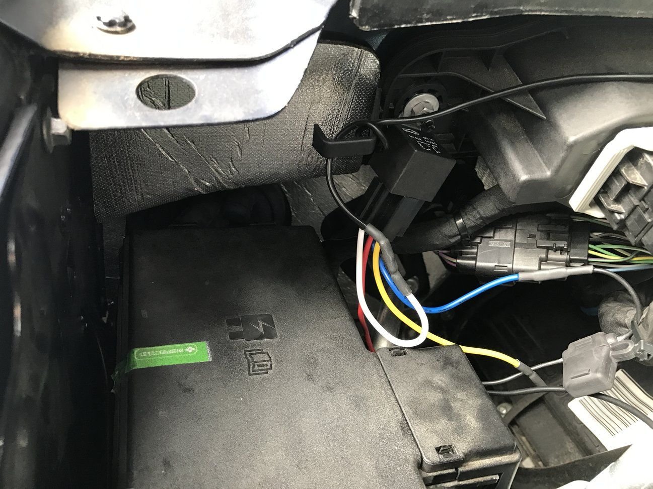

Just a couple pics for the heck of it:
What size wire did you use? Looks pretty clean with the black coating on it. Thinking of doing this to my truck just for dirt use.
Old Dec 29, 2020 | 08:45 AM
  #29
ATC Crazy's Avatar
ATC Crazy
Top Answer: 10
Joined: Jun 2003
Posts: 12,353
Likes: 4,389
From: SW VA
I'm not 100% sure on the wire size, but I think it's 14ga. That and 16ga is what I keep the most of around the shop...got a good deal on it!
Old Dec 29, 2020 | 08:59 AM
  #30
Crotchety Ford truck only's Avatar
Joined: Dec 2019
Posts: 863
Likes: 35
From: MA
ATC inline fuse holder wire looks 16 and others look 14
