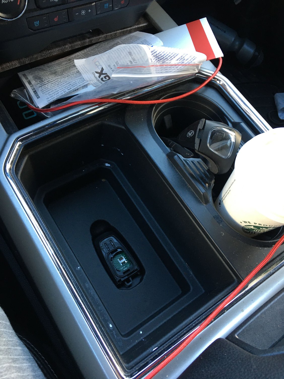

you can unlock your truck with Ford sync
you can start it with Ford sync by not drive offf
rhe physical indent is located under the rubber between cup holders.
maybe if you put the fob there you can drive the truck
in curious and am going out to the truck to try it
this reminds me of something I have been wanting to do ...order a magnetic key box Put a battery in original wrapper in it, and stick it to the metal frame.

I took the battery out and tried it. Started with no problem.
so the solution is Ford sync to open the truck and put the fob in the compartment under the mat in cup holder area.

So I did a Ford sync start
put the key in fob slot
pushed start m
truck stayed running from Ford start and let me drive it.

I know about the depression under the mat at the bottom of the console; I thought it was used for programming the fobs. I saw another post showing a depression under the forward cup holder in which the fob was shown sitting upright. I don’t have that. But if the truck will start by placing the dead fob in the lower depression, I’m good.

Anyone have a pic of the under mat position? Is that the floor mat or the one I posted in the console?
