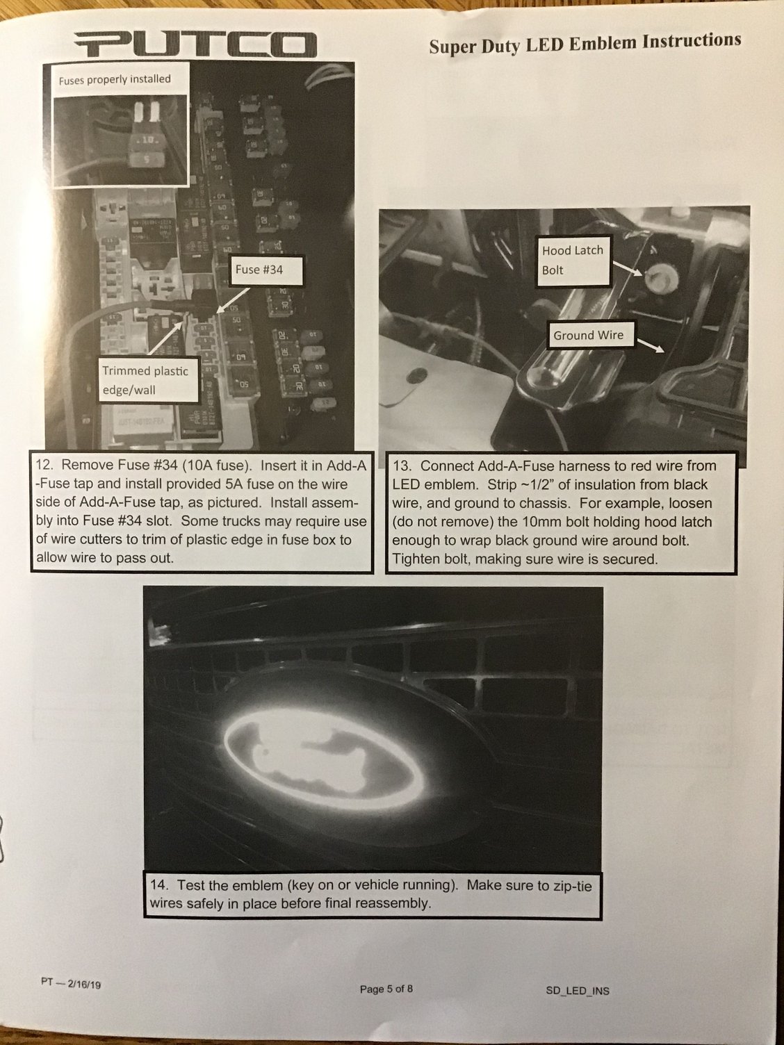

For anyone that has installed the Putco Luminix lighted ford emblems, I have seen on some install videos that they have you use a fuse tap on fuse 34 for the front emblem. I can't seem to find any written instructions online that confirms this. Does that fuse make it power up when the truck is on and stay on, or does it light up when the running/head lights come on?

I installed one on my 2017. I followed the instructions and fuse tapped fuse 34. It powers up when the headlights come on. Here is a picture of the instructions.

Awesome! Thanks for the info.
