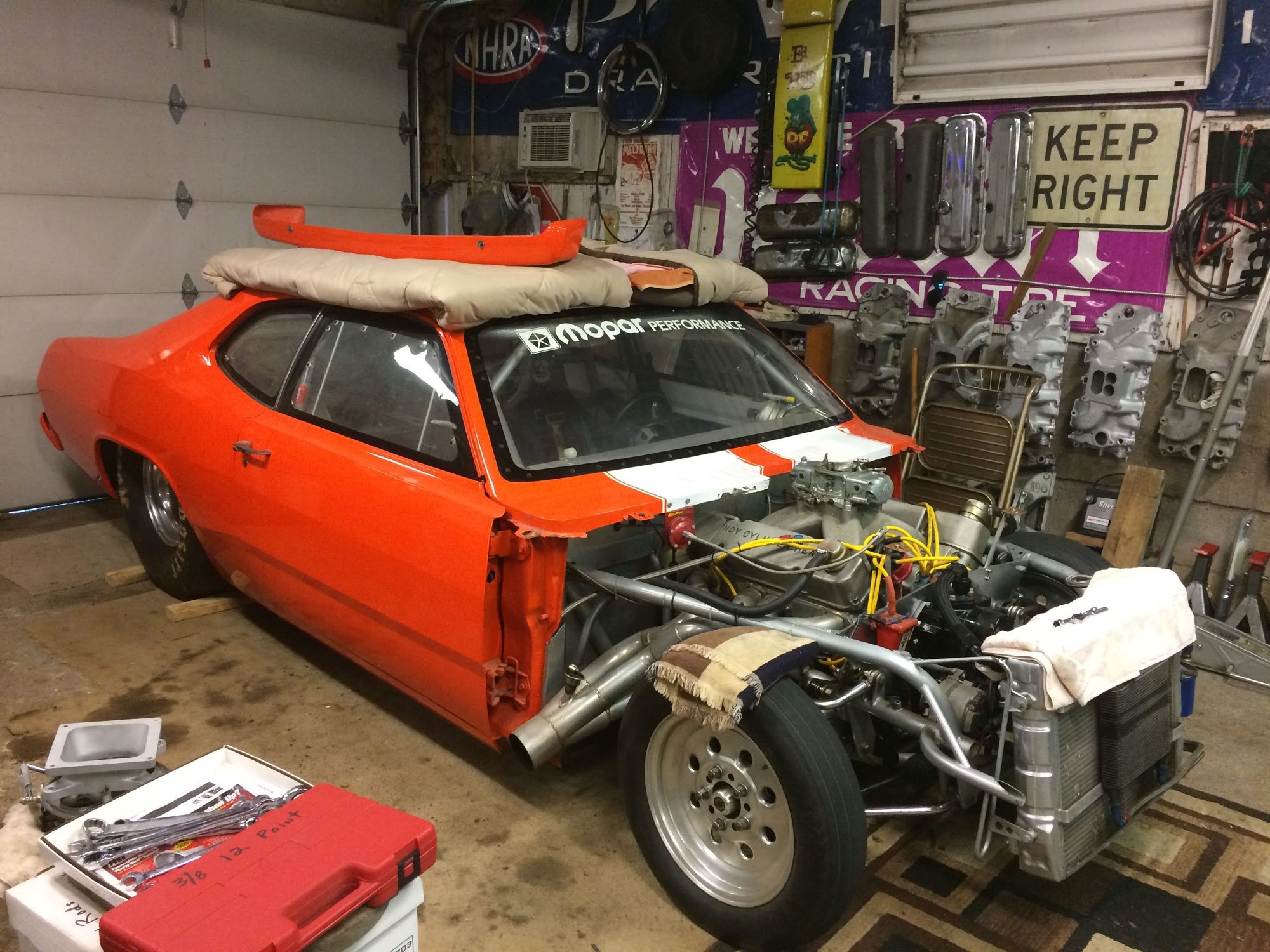

I will take a look at all of them later today. I had bones in my hand rebroke yesterday and reset. So needless to say I am in a lot of pain and have to wait till my pain meds kick in. I want to know everything about the 6.0 because I am a car guy that does all his own work on my cars including my race car.

Sweet rigs, btw!
