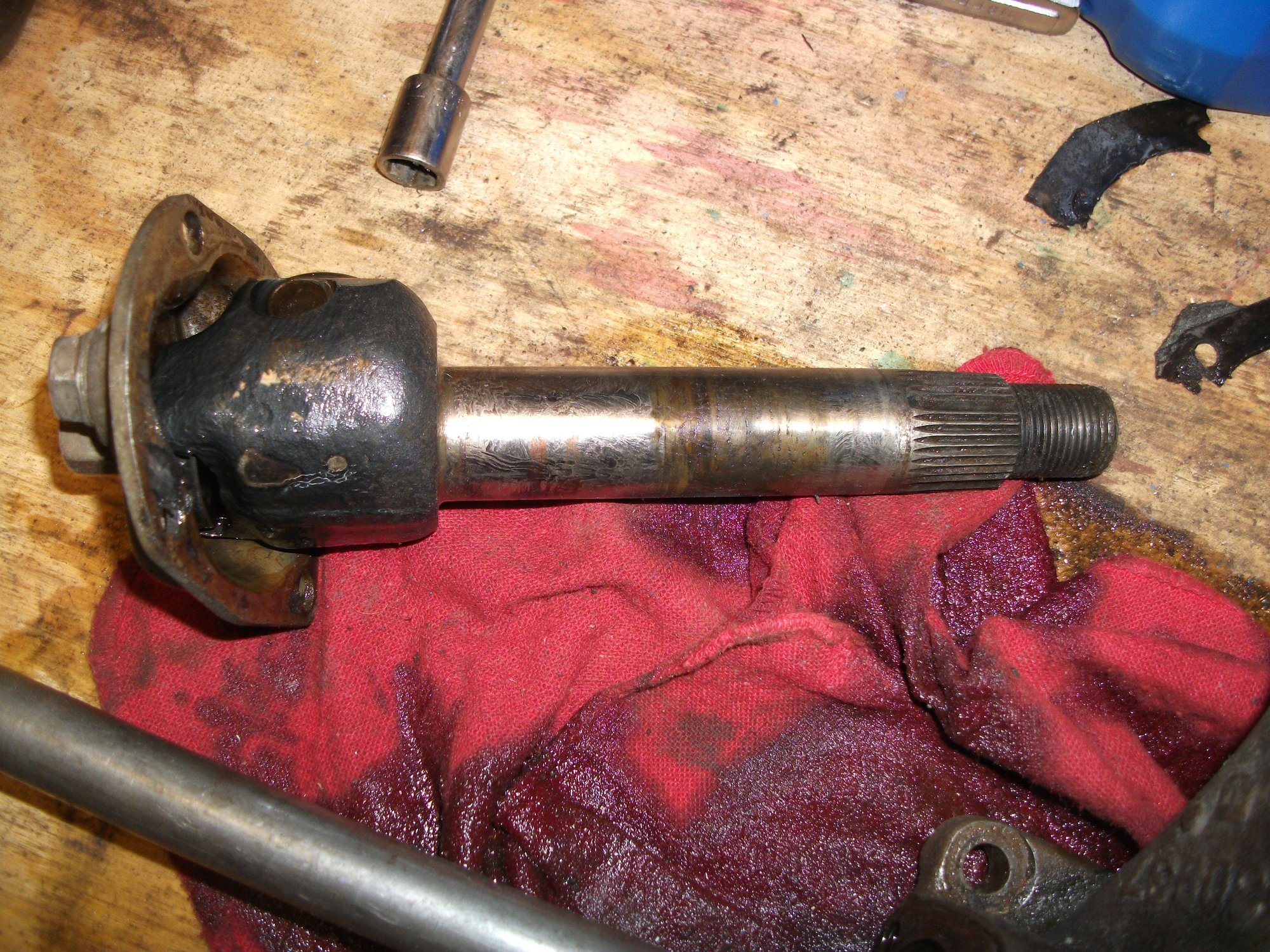

Rebuilding is fairly easy since there really isn't much in there. Let me rummage around for a picture or two.

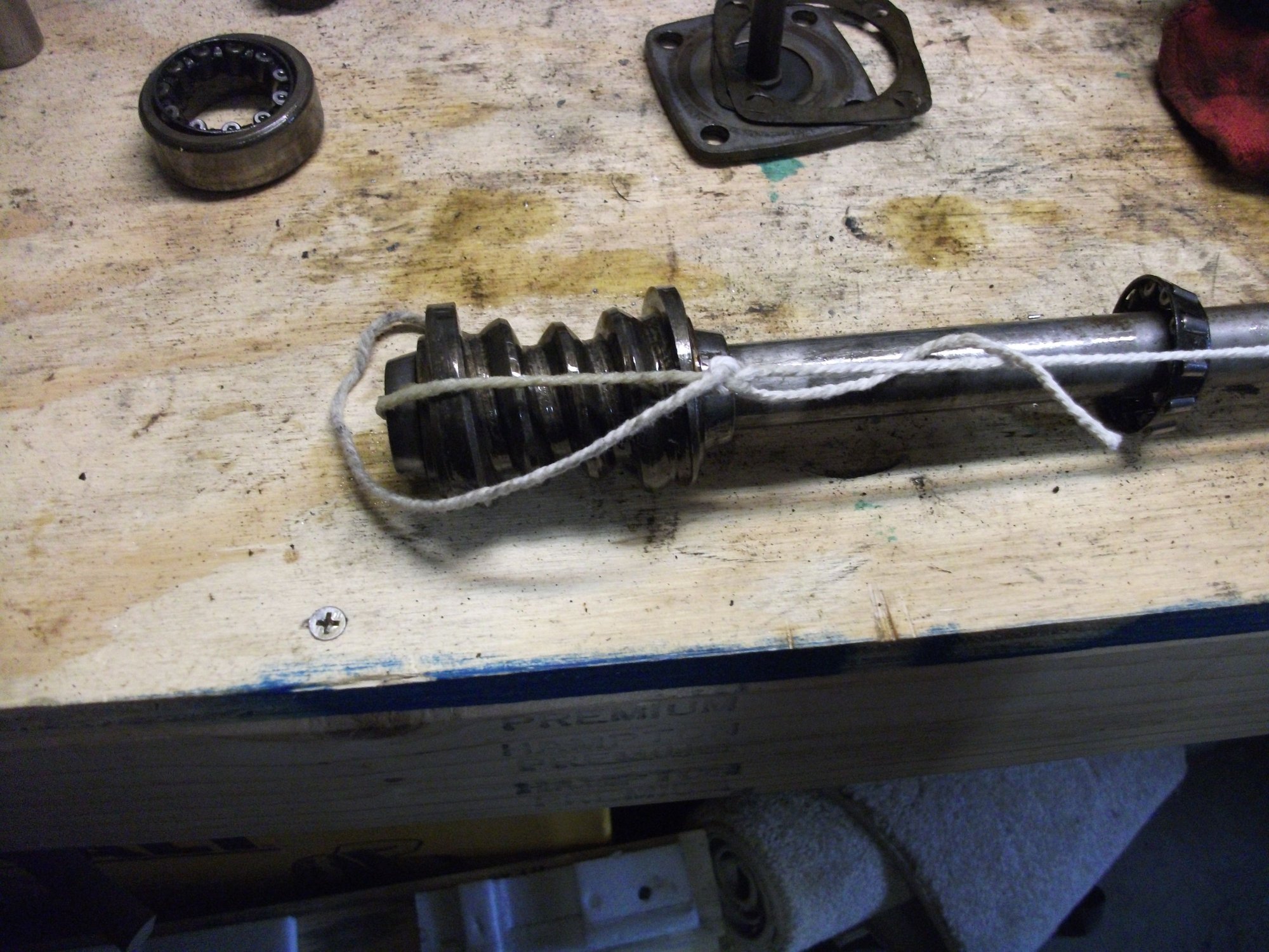

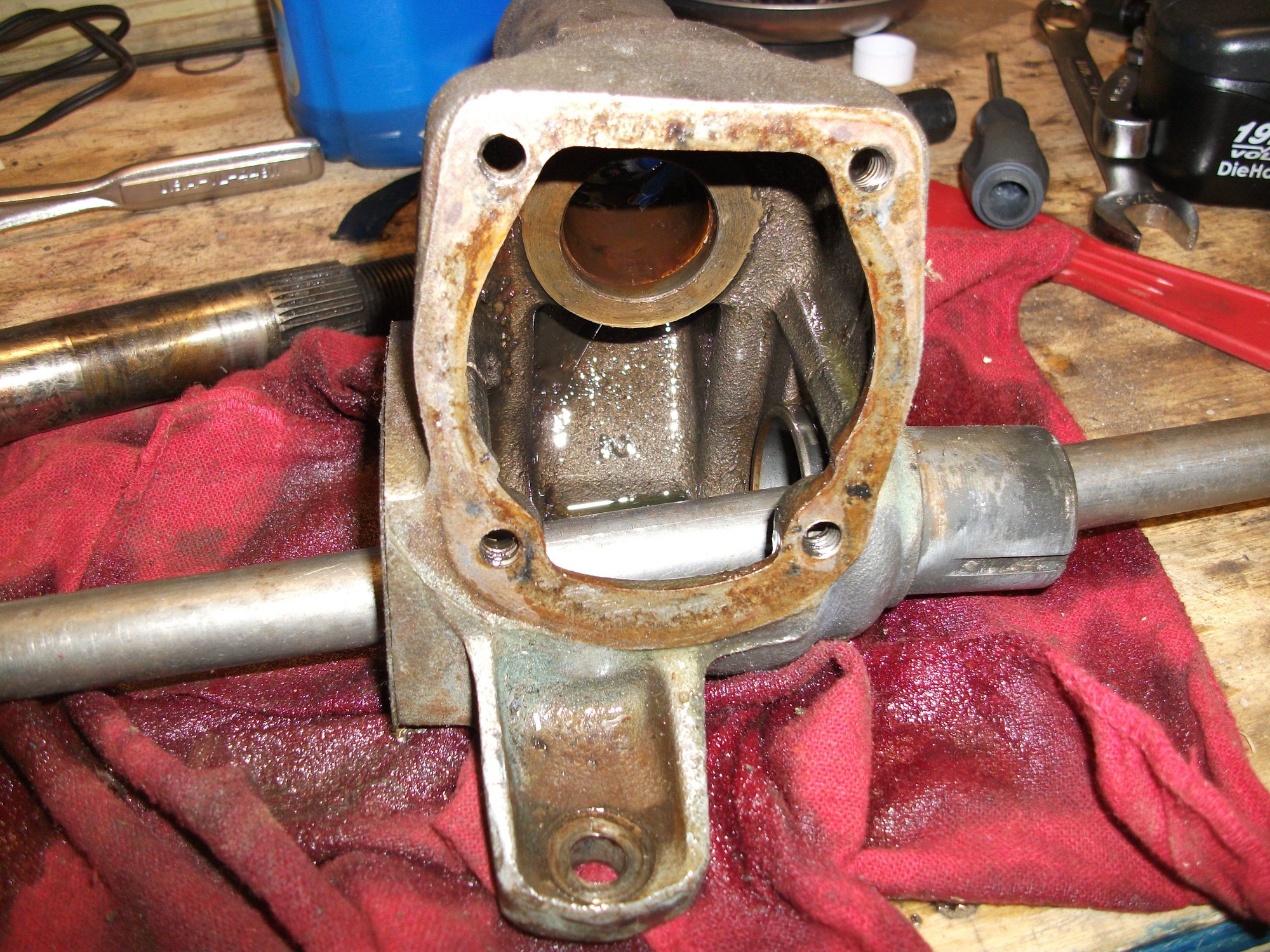

Couple tips:
Some boxes don't have a reveal edge to access the upper worm bearing cup/race for removal with a drift. Carefully run a bead of weld on the face of the race and it will fall out.
When pressing the worm onto the steering shaft, the shaft needs to be supported from flexing and possible bending. One easy way to do this is to stack up some 2"x4" wood pieces with holes drilled through them to accept the shaft, screw those pieces together to make a solid unit and the shaft will be supported. Another method is to weld a washer or nut onto the shaft for a support. The washer can be left on the shaft or removed...it won't interfere with anything.
Good luck!

Impressive chunk o Henry steel right there. Could melt that down and build an entire Yugo, I betcha!
