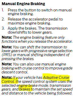

I thought i read in the owners manual that the engine brake uses engine, trans and braking in the auto mode.
That's the beauty of online manuals ... we don't have to rely on our memories; we can look stuff up. You're conflating engine braking with adaptive cruise control. It functions as described previously in this thread. If you're using engine braking, it will use transmission, engine compression, gears. Done. Engine braking doesn't use the brakes.
If you're using adaptive cruise control with engine braking engaged, the adaptive cruise control will use everything in its arsenal to control speed and following distance: transmission, compression, gears, and, yes, the disc brakes.
