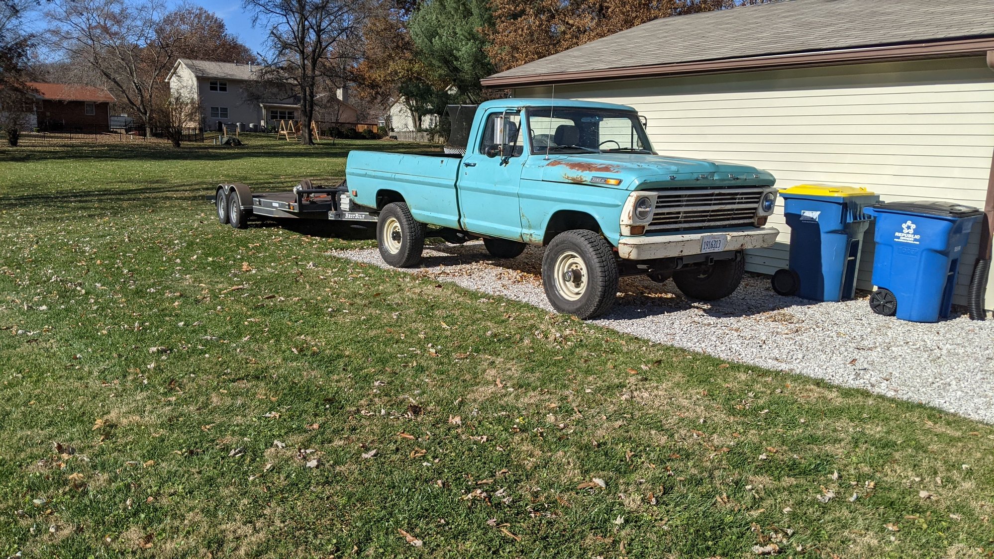

Truck outside the garage with my new old bumper. Don't know what I will put in yet but there is plenty of room.
