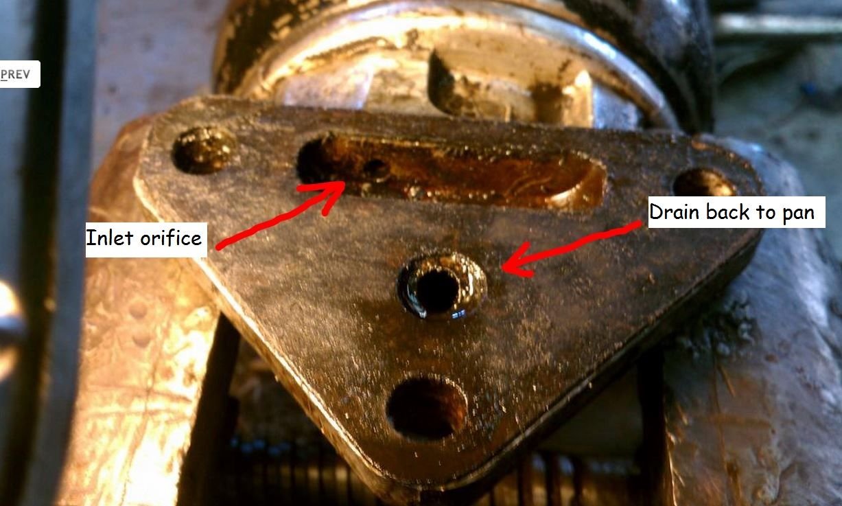

oil filter unit is bolted on
Originally Posted by ALBUQ F-1
I think you can, just make up a blanking plate. It is still a bypass filter, not a full-flow.
She’s definitely bolted on (and leaking!) gotta pull it off, maybe needs a gasket.
Valve covers a leaky too.

needed a gasket.
the whole unit unbolted, and the canister disassembled with 4 bolts.
I was sorely tempted to make a cover plate and toss the canister!
Made both gaskets, bolted it back up, so far, no leaks.
