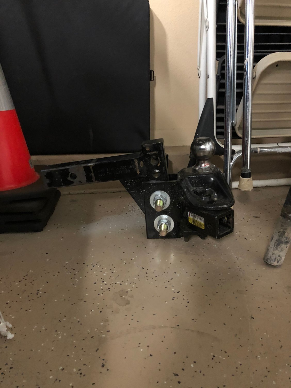

I had an 8" drop extended hitch setup that worked with all my trailers but was really big, heavy and ugly. I was lucky to find a clean weigh safe 8" drop hitch online that I gave a fresh coat of paint and npw have a much cleaner setup. It has a second pin hole on the shank so I can extend it out a little for my rock tamers still. I have a stock height 2017 F350 with 35" tall tires and it's 15" from the ground to the top side of the ball mount.
