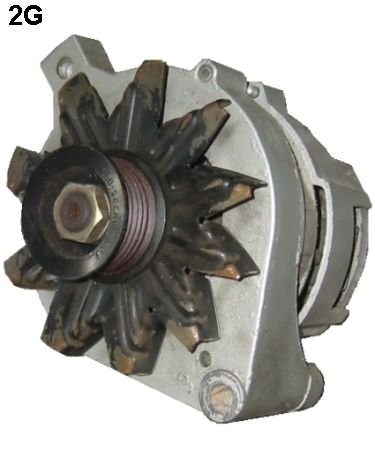

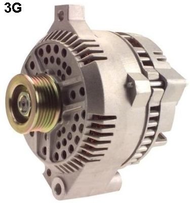

I just changed out my 2G 75Amp in my 94 F150 and replaced it with a 3G 95Amp. Here's some pictures..
2G
3G 95 Amp
