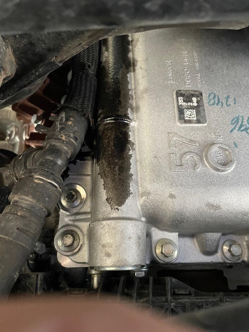

2017 Ford F-350, 6.7 Diesel, 60k miles...
Have you experienced this oil leak from the front oil pan/plate? Had this show up at about 52k, took it in under powertrain warranty. They replace the entire front pan. Now, 8k miles later, the same leak has shown up again... Appointment made to "try again"...

Search for UPPER OIL PAN LEAK.
You will find a huge number of posts.....

Yep mine has been seeping on my 2018. Does anyone know if this is covered under some sort of powertrain warranty? My truck is a 2018 with 75k miles.

Mine was covered under the Powertrain warranty, however, I didn't expect to have to take it a second time for the exact same thing....

While watching a you tube video last evening on fuel filters for these trucks the guy mentioned he had this same problem. Turns out it wasn't the pan it was some sort of oil vent or separator located around that area. I can't find the video but I thought he said there was a TSB for it.

Mine does the same except it's quite worse. How long did they have your truck to repair the first time

My 2005 did leak to the point I didn't park in anyone's driveway. I used it as my rust prevention program. But when my 2017 6.7 started leaving a puddle on the shop floor I was sickened. Not again! It was repaired under warranty but the paperwork had a comment to keep an eye on it. That didn't make me feel like they had much faith in the work but so fat so good. I talked to a fellow in Canada who had a brand new engine put in because of the leak. On his they found a casting problem.

My 2018 F450 did this and I waited until 7k miles to get it fixed. It took over 2 weeks. The tech noted that the upper oil pan was leaking. Upon removal of upper oil pan, it was pitted and could not be sealed properly. The new replacement oil pan was also pitted so a second new one was ordered. The second one was not pitted and installed. 20k miles on this fix and still no leaks. Don't know if this is the case with yours, hopefully it helps.

Just shy of 2 weeks..... I have an appointment for next Tuesday, we'll see how long this one takes...
