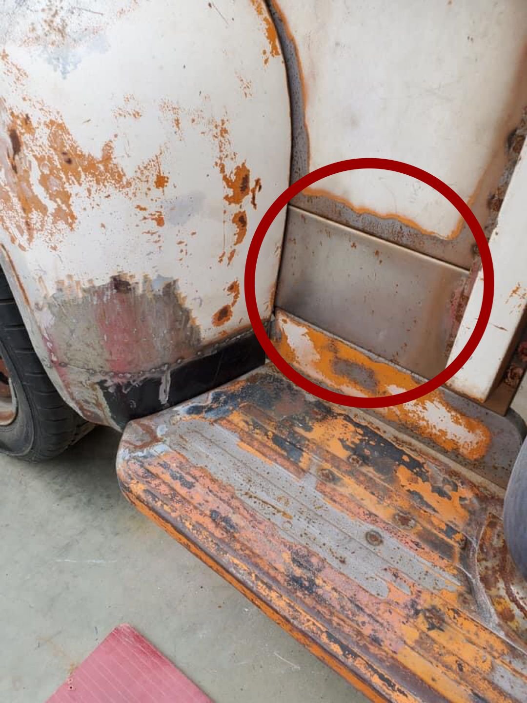

My next question is actually a request for a source. At the shows I’ve seen Ford Script in the front lower bed panel where the bed meets the wooden bed floor and the running boards. As shown in the circled piece in the photo below. Does anyone still make these?
Stamped Ford script???

I think the ford script wasn’t on the bed but on the kick up on the running board. They were on the fiberglass running boards. I haven’t seen any in years

I remember seeing those embossed panels years ago. Early 2000s, but haven't seen them in a while. I had thought of using them too.
I check a couple of venders and saw Macs has the separate panels. No stamp though.

Just thought they were sorta Kool. Also saw a couple of trucks that had small toolboxes there as well.

Years ago, someone used to make and sell a piece of sheet metal about 12x12 inches, maybe a little bigger, that was stamped with the same Ford script that was used on tailgates. It was great for doing the little custom touches like you're talking about. I haven't seen them for a long time. My guess is they went away when Ford started cracking down on copyright and trademark infringement, and the makers were either told to cease and desist or didn't want to pay license fees on them.

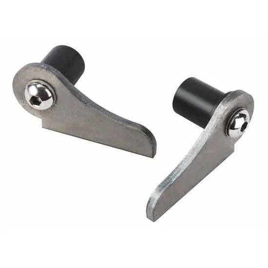

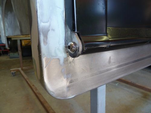

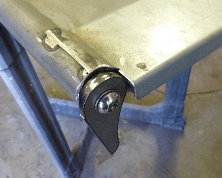

Really not much to them. They just prevent all the bumping and banging the old hinges do.
Hidden Tailgate Hinges Require Welding From Speedway

Those hinges are called "Hiding Hinges" and they are made by Pros Pick. The first set I installed were not to my liking, followed the directions but when they are mounted using a butt weld they are not very strong. Since then I have installed many of these hinges and in each case I mounted the hinge flush against the pinch weld lip of the bedside and notched the tailgate accordingly. The hinge is now very stable and is tucked into the lip of the tailgate which makes for a very clean install.
