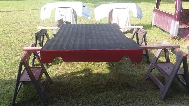

If you have a welder, some flat stock and sheet metal and time, the last a little more than the first 2, you can fix them.
Now to pay someone to fix them would be way too too too much money and why I said "If you"
Have you looked to see what parts you can get? I don't know about your year as I have a 81 flare side and can get just about everything but the bed sides and glass fenders.
In my case just the bed floor cross members & front & rear sills would run $1000, then add the wood, metal strips, front panel and hardware was just to much for a $800 weekly trash run truck.
I was able to fix the bed sides with metal & welder, did glass work to fix cracks in the fenders and used a style side metal ribbed floor in place of the wood and bolted the bed side to it.
If you did a quick look and did not know it should have a wood floor you would think it was factory.
The way it was done I can unbolt the bed sides and do a wood floor and bolt the side on like the factory did.
I don't have to worry about putting anything on the floor and hurt the wood. The truck was built as a driver and do take the trash to the dump weekly.
Cardboard in bed for the dump, trash bag is in there also.
Don't get me wrong I love the look of a wood bed I just did not have the $$ and had a parts truck bed with a good floor and bad side from a roll over.
That rear tank was added from the parts truck using factory duel tank parts to do what the factory should have done!
Checking other year threads and projects to see what other are doing and you can take clues and use them when building your truck but if it a "factory" built then you cant move from that.
Good luck and keep us posted on your project.

Dave that bed looks great!
Thanks some times you have to think outside the box when you don't have the money to go back with wood and have a long bed style side that the side was caved in on.
I also like to post things like this as it gets others thinking on how to fix something or just the push they needed to get going on their project.
Dave ----
