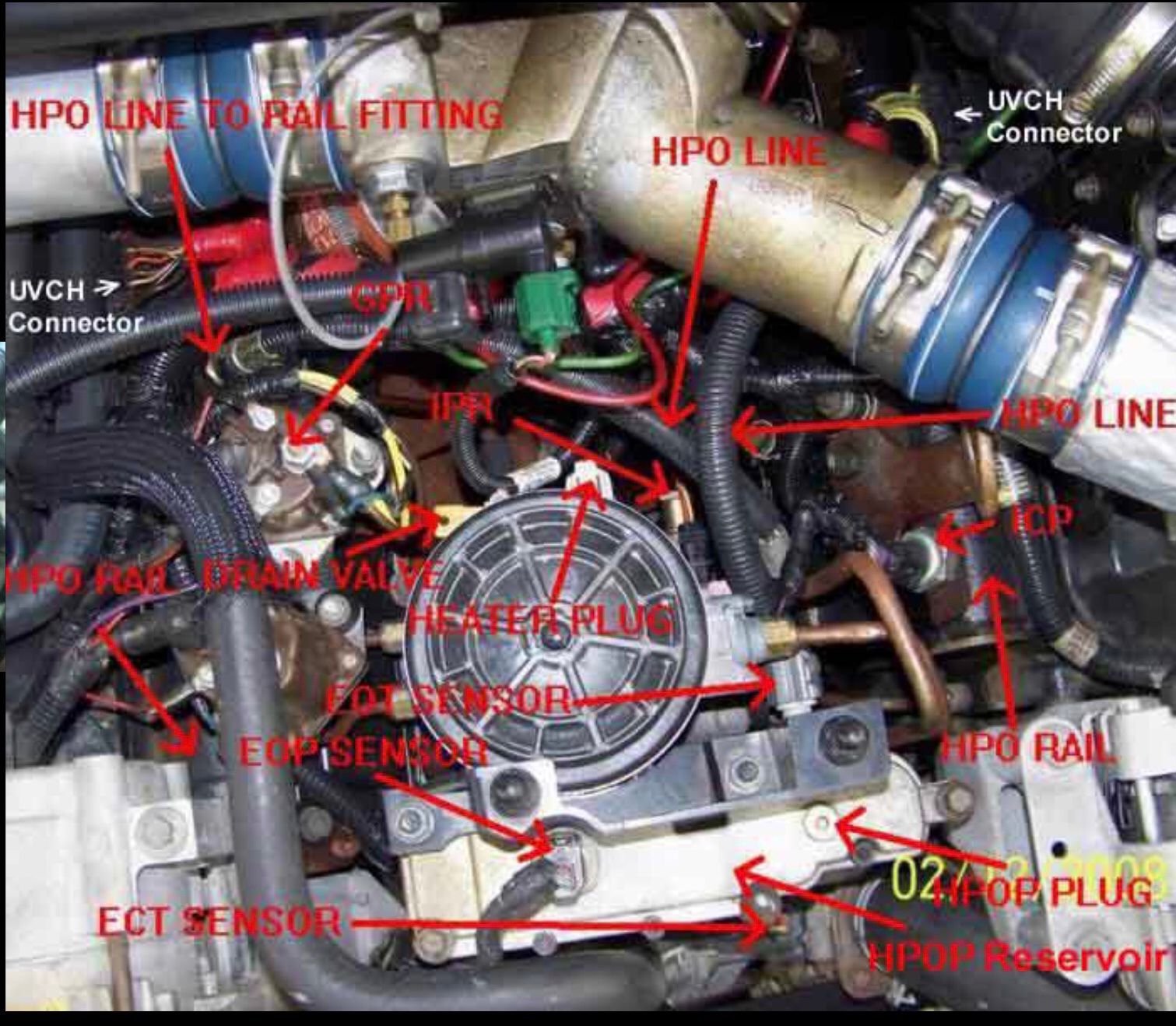

The fuel bowl heater has a connection in the back of the fuel bowl, Just unplug it and never think or worry about it again

Is there only 1 connection on fuel bowl? Hate to unplug wrong one
I thought I had a better picture but if you look at the fuel bowl, you’ll see the plug being pointed at by the red arrow...
