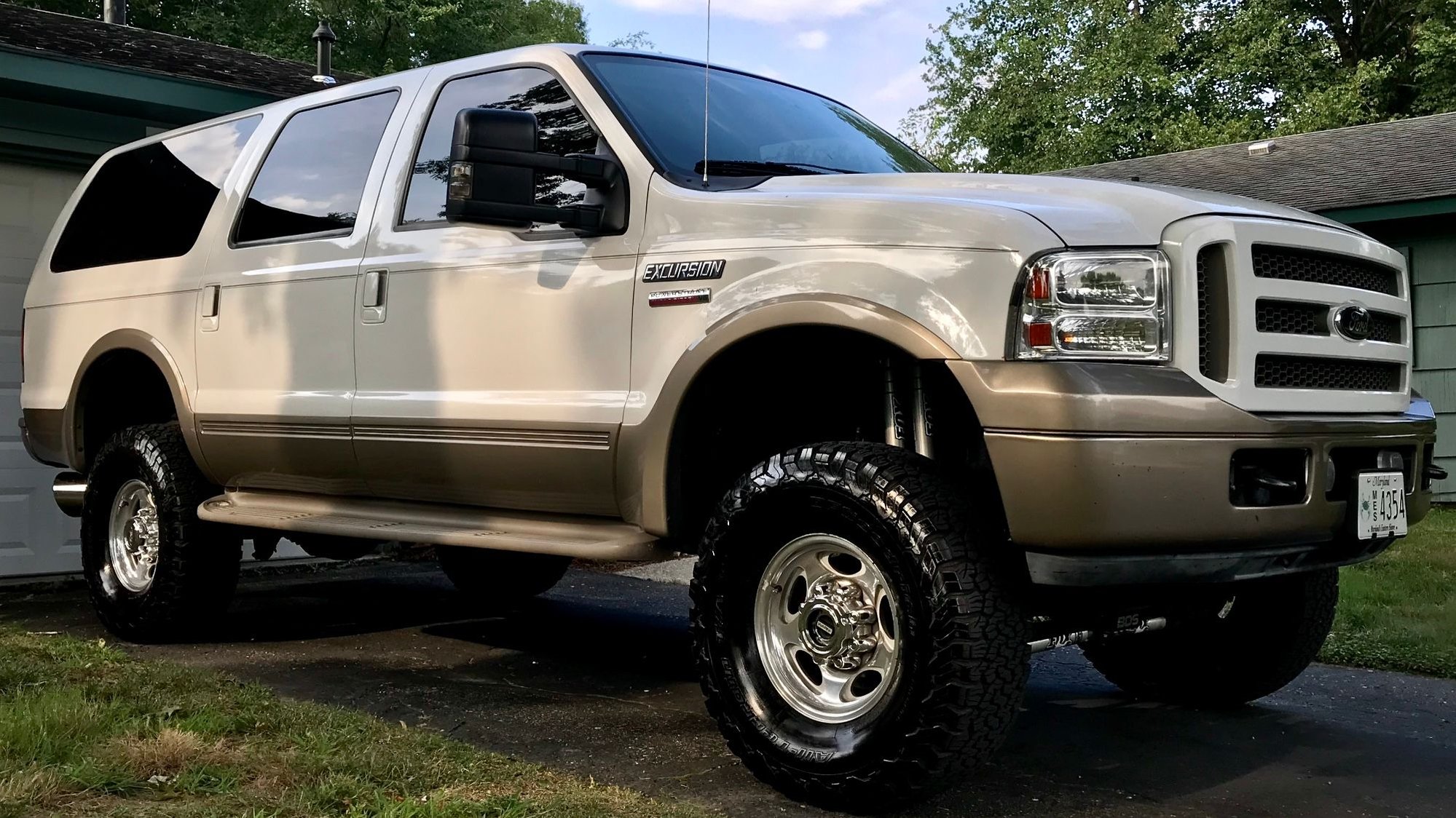

What are you guys running? I have a BDS 6 inch lift and I’m looking for a good set of traction bars. I’m searching but having a hard time finding them for Excursions. My buddy has Pro Comp on his and they look great! But I can’t find a part number.

Your Excursion is amazing looking! Keep up the good work!

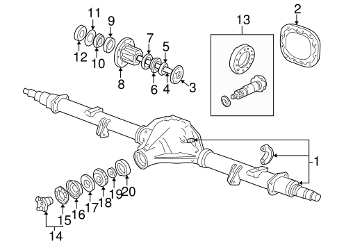

oil seals in the rear #12

I plan on welding where noted below, how does the differential case mate to the axle tube ( housing ) ?
This looks lie a joint itself. ?
From what I can make out these tube's aren't very straight to begin with so warping should not be an issue
(unless a massive amount of heat is added to a concentrated area)
BTW - do you happen to know the thickness of this tube ?
I am guessing its at least 3/16"

axle tubes are pressed into the center section, 3.5" axle tube is .500 thick in that area ( it is a tapered tube to save weight. )
